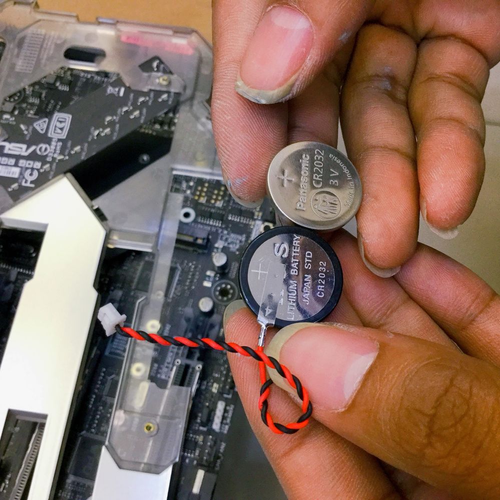

OMG WHO DESIGN ROG RAMPAGE VI EXTREME CMOS Battery placement!?
restsugavan
Level 15
86239
Why did ASUS Engineer design CMOS battery placement so badly?
Do you think ROG RAMPAGE VI EXTREME CMOS battery never run out ?
86240
Only one battery replacement need more than 60 min to disassemble the ROG Armor.
86241
Please do not use these method for next ROG RAMPAGE VII EXTREME for Icelake X
or not I will choose other brand instead.
86242
Can’t believe the most expensive mobo also expensive time to replace CMOS battery 🔋
Beware everyone only 3 years battery run out shortly. And you’ll see this experience like me.

bmcbride1991 wrote:
I ran into this problem this week the cmos battery died. I have a custom loop also. I ended up cutting the two wires off the old battery and soldering on a single cr2032 holder and routed it to the outer part of the motherboard on the bottom.
Here is the holder i used: https://www.adafruit.com/product/4856
hope this will help someone 🙂
But you still have to dissassamble all your loop? I have a custom loop with hardtubes and 2 GPUs and my battery died yesterday.
So now i have to dissassamble the whole system?
How do you remove the Armor, I have removed the lower right section, but how to remove the rest? Is it held in place with screw access from the the back / underneath the motherboard? I cant seem to find out how?
Kind regards.
Kind regards.
You will have to remove the MB completely. The armor is held on by about 8 screws that can only be accessed from the back side. In addition, the MB edge-lit LED panel is also attached with several screws and you will need to remove that to access one last screw holding the armor plate. A major PITA.
GEEKCPA
Level 8
I just discovered the same problem. How did you get the battery out? Did you have to remove the black vinyl to find a traditional battery latch release somewhere? Is an after-market holder described above the only solution? What a freaking mess!
taedeen
Thanks for your post, I am about to do the teardown now .. I love the look but really  should be a 2 minute job 😭 as every other board.
taedeen
After the experience of a full teardown, I will not being that again....
Added an extra cable and a modded RGB cable..  will  make it a quick swap if the battery dies in 5 years
