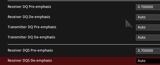

Shamino
Moderator
just based on guessing, set the following
68408
68409
and set uncore voltage offset to 0.001
68408
68409
I tried a few more re-boots and everything works fine after making the suggested changes. However, after installing the Sound Card (SoundblasterX AE-5) it hangs during reboot again with the same "Detect Memory" code. I remove the sound card and the board still hangs with the "Detect Memory" code even though the previous recommended settings are still in place.
I use 'safe boot', I don't change anything and exit the BIOS and it boots fine into windows.
Could this be a PSEU related issue. I'm using a mew Corsair CX650M just for testing (the rig it's going into has a 1500W PSU). I'm not using the 4 pin EATX12V_2 connector since the PSU does not have a cable for it. I am using the 8 pin EATX12V_1 connector.
Should I return this board? I shouldn't need to make so many adjustment just to get the thing to boot properly.
Homewrecker
Level 9
Thanks. Tried it. When I saved and reset I got a code that stated "Check NV Ram". I reset again and it booted fine so far.
How come the lower uncore voltage compared to the previous suggestion?
Should I back-off the CPU AUX2 and Input reset voltages to find the threshold or is it safe to leave there? Does this affect the CPU Temp?
I'll try a few more reboots and install the sound card again. If this keeps happening though would you recommend that I return the board?
