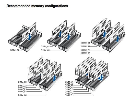

lPlease try to make sure the memory is pouplated populated from the manual's diagram.
90095
90095
I suggest updating latest video card drivers from Nvidia.
I also suggest performing disk error check and perform system file checker ( DOS (admin) - Sfc /scannow).
Back up all data and please update bios to 3403
99 times out of 100, I would agree to follow the manual etc BUT not when it comes to Rampage VI Extreme (not encore).
Many R6E board owners (but not all!) have a h/w issues with right side memory banks! I am one of the unlucky once. and there are more unlucky once who posted on this board, see separate treads... like this tread: https://rog.asus.com/forum/showthread.php?109123-asus-rampage-vi-extreme-ram-problem. etc... there are few more just search...
