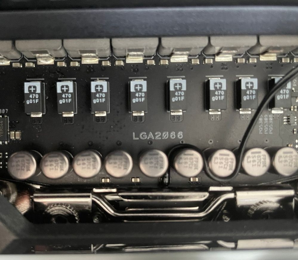

The cpu is 10980xe, basically the issue is under load the area around the vrm getting extremely hot. Much hotter than the vrm itself.
The electrolyte capacitors above the cpu socket went 5-10 degrees above the vrm temp and the substrate around the vccin delivery plane also getting similar temp.
I suspect the power plane traces on the board was not big enough to sustain the current/power draw from 18 cores cpu hence it heats up.
My first board started to throw lower vccin reading although it was running normally.

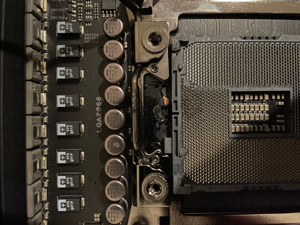

I noticed the melting plastic insulator around the cpu socket.
89125

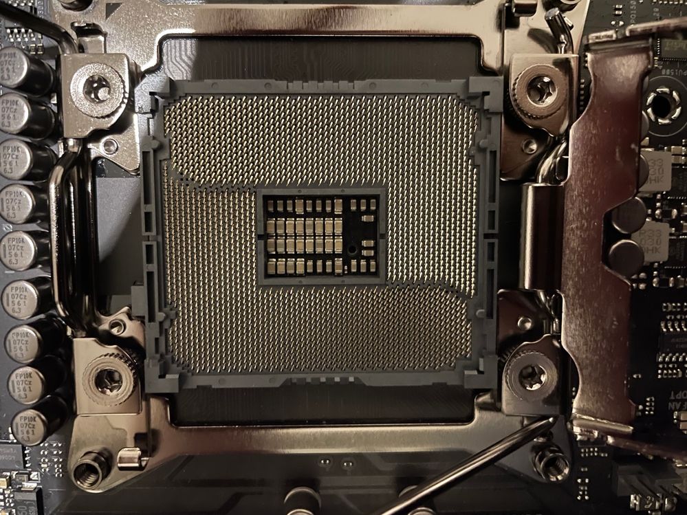

On new board it supposedly like this,
89126

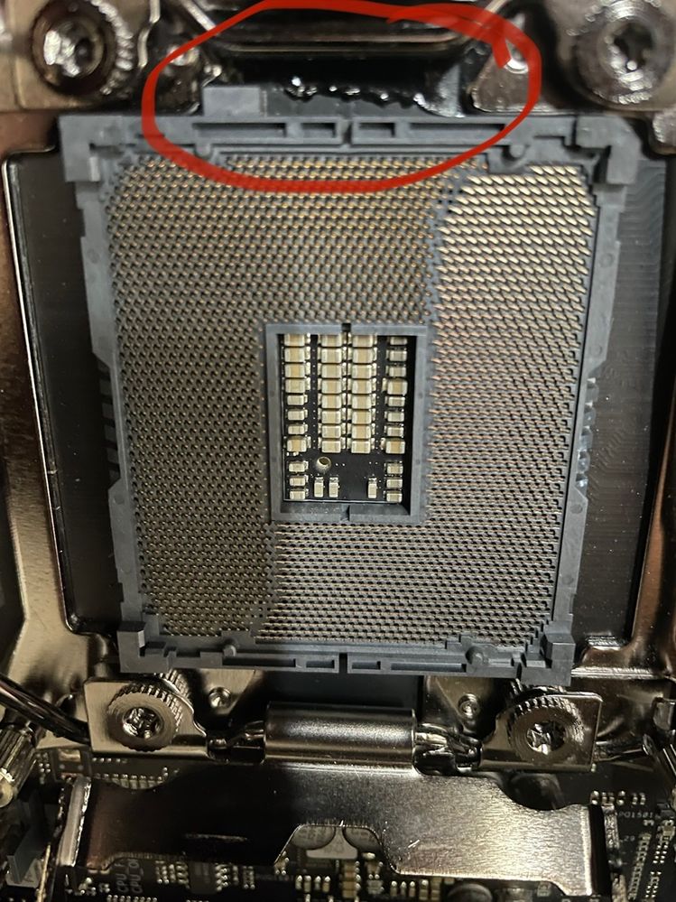

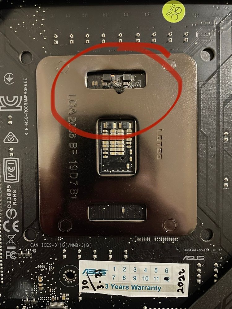

The second board I received from RMA burnt down like this,
*89127

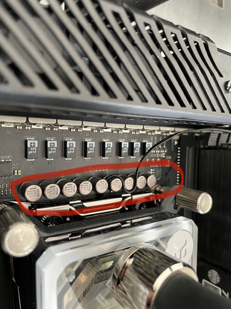

So with my third board I start to monitor the board temp. I install temp sensor near the previously burnt component like this.
*89123

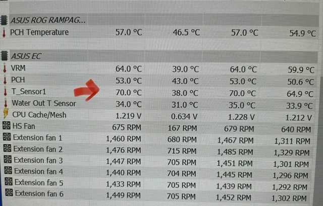

And the result is as mentioned it is super hot in my opinion. Without overclock the substrate/capacitors goes upwards of 73 degC depends on stress test used. And it is hotter than the vrm.
89129
With very slight oc (200 mhz from all core 38 to 40) it went up to almost 80 degC.
89129

Hi there, yes I know very well not to remove the vrm heatsink and I connected all 3 power connectors. In fact the overheating components is not the vrm. The vrm itself is completely fine. I was more worried about the power delivery between the vrm and the cpu. The components in between the vrm and cpu getting extremely hot I believe due to insufficient power plane traces surface to handle overclocked 18 cores.
It is not an issue if you didn’t notice this flaws. But once you noticed this you will definitely start to worried. Let alone stress tesing using prime 95, just running cinebench r23 or blender benchmark brings the temps of those components significantly high.
I asked you same question on onverclock.net forum, noticed that you have encore board also. Can you try to carefully touch those capacitors after running cinebench r23 for 10-15 mins with your overclock please? This is not newbie mistake. It would help other people too not to burnt down their house if this is indeed design flaws.
These capacitors, no need to remove the board or anything it can be reached from front side easily unless you are using monoblock.
89131*

At the least. your images show melted plastics and an extremely remote possibility of melted solder! What CPU cooling solution are you using and is it certifiably on and running at least at 100%? I am not aware of any plastics, especially adjacent to the MB CPU that have melting points at, or below, 100C (more likely the melting point is >120C, or even >140C, that would be for polyethylene (e. g. PE, the stuff that most all shopping bags are made out of)).
Your 2nd MB shows extensive heat damage to the CPU socket itself, throughout the backside, and the triangular area of socket pins on the front side directly adjacent to the edge closest to the melted plastic.

The second board burnt with 47 all cores oc during rendering task. The socket burnt because the board burnt and melted the socket. It was not caused by the cpu per se (the cpu still drawing lots of current from it but I’m 100% sure it is not the cause). The cpu survived without any scratch.Â*The same cpu used on the third board and it works flawlesly except hot capacitors. I start to monitor its temp only with the 3rd board after the second burnt but photo from my first board shows similar sign (using the different 10980xe).
