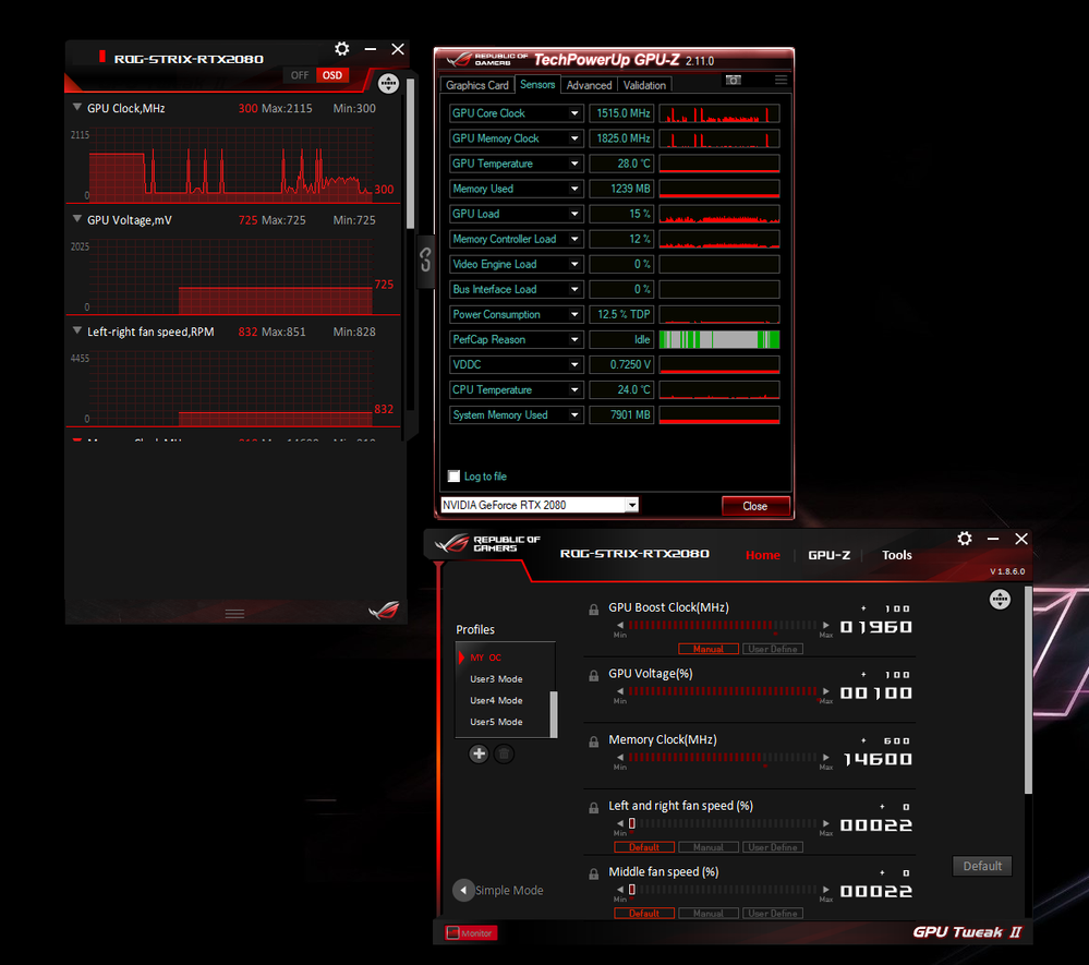

Just checked my OSD in 1.8.6.0 and it updates clocks correctly on the RTX 2080, are you able to replicate that problem every time? May just be a polling error due to running multiple tools at the same time.

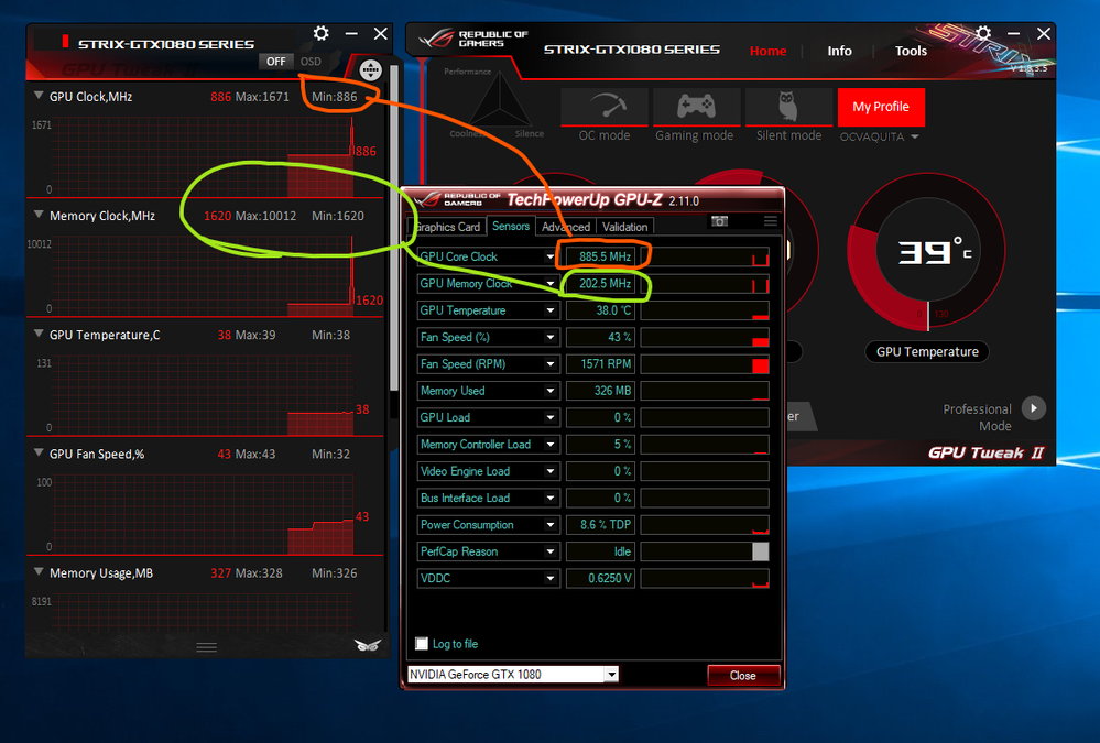

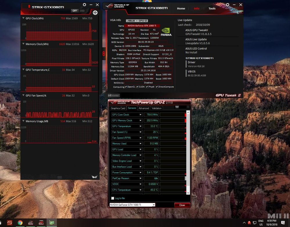

Regarding the replicate.
here it goes.
I just install a strix 1080ti OC and same issue.
still using the 1.8.3.5

Yes, that's my mistake. Wasn't aware at the time of writing that revision was exclusive to Turing. The memory speed reported is fine, it's just how GPUZ is reading the memory pumping compared with GPU Tweak. I've just checked this on 1.6.5.0 with a GTX 1080.
