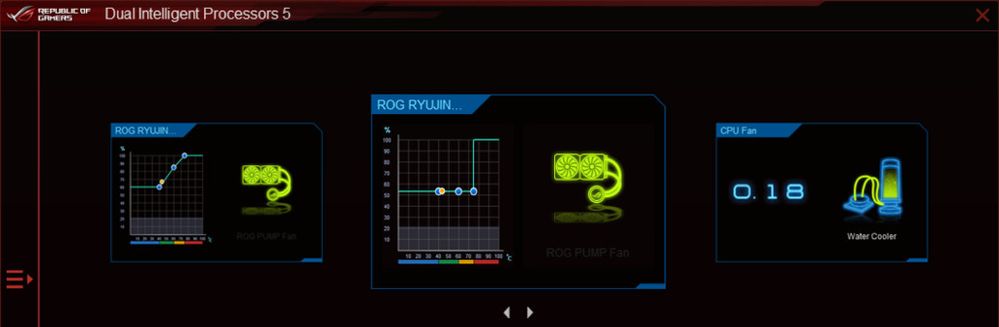

I'm also running a ryujin (240). When setting my fan curves on Fan Expert on AI Suite, you should be able to see 3 Ryujin fans you can control. For me, the first one is the pump speed, second is the actual Noctua fans on the radiator and lastly is the small fan on the CPU block. I'm not sure how you are able to control the cpu block fan and pump under one curve?
I only have two curves that I can play on.

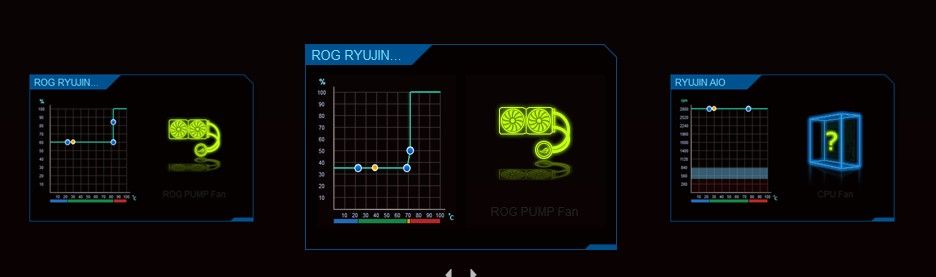

84433
These are the 3 curves I can control.
I compleatly uninstalled AI suite to stop it from fighting with armory crate. Armory crate controls my ryuo. My current case fans are controlled with a remote anyways. I plan on swapping to nicer fans that the MB can control(cheap hub currently, no pmw signal to the MB). I'm just gonna adjust the fan curves in my bios and forget about the on the fly control in windows. It'll be quite at low temp and it'll be taking off at high temp, all that really matters.
Also make sure the AIO is plugging into the AIO header and not a cpu/fan header. Fan headers are throttled and the aio header isnt. Pump should be running full blast the whole time.
