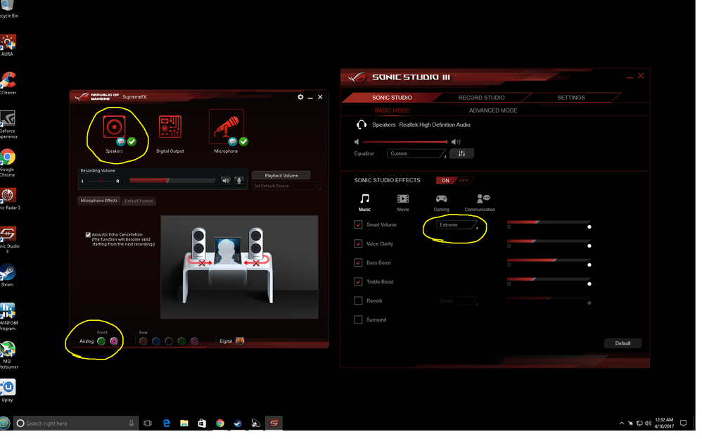

All right
So I connected my headphones to the case jacks and when I did SupremeFX came up and asked me; "What did you just plug in" ? It had mic checked and said something about the impedence and said it was set to extreme. In sonic studio 3 it gives you soft, balanced or extreme.
It sounded great and the EQ worked with it too.
Did SupremeFX ask you what you just plugged in ?
Do you have the Realtek audio driver installed along with sonic studio 3 ?
