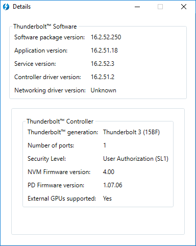

I checked I have PCI\VEN_8086&DEV_15c0: https://vendev.org/pci/ven_8086&dev_15c0/
Gents is there a difference between the 702 and 502 maybe?

I have a GL702VM and based on all the info I could find it is using the JHL6240 half speed controller. According to my searched 15BF is the LP controller. So not all GL702VM's are ising full speed controllers. Am I wrong??
64985
Edit: Just noticed someone already pointed this out.
It would be a joke if only it was funny. I've received two different answers from two different Asus representatives and one of the has confirmed the official Asus websites contain the wrong information.
Quite simply Asus should only update the Thunderbolt firmware for external GPU compatibility on machines that can run an external GPU at full 40gbit/s.
That would be the one surefire way of informing people of what hardware they have.
Download firmware and start the install. If it's compatible it will install, if it's not it will show a message stating that the Thunderbolt port/controller is only half speed and therefore not compatible.
Come on Asus, it's not that hard is it?
