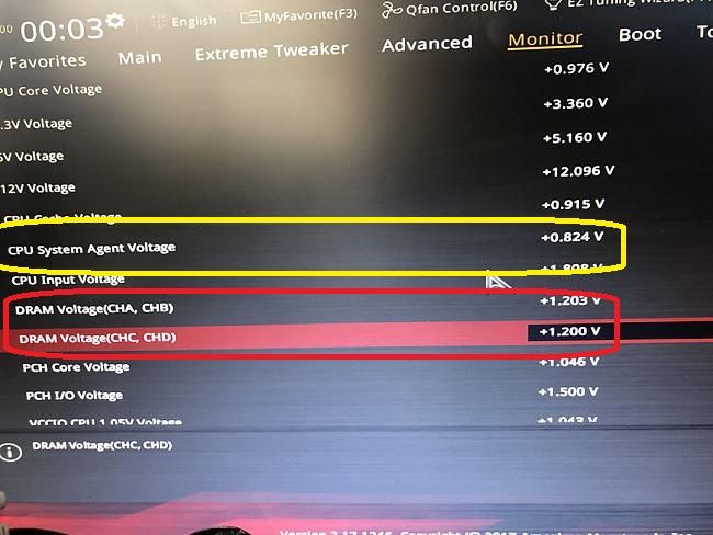

Could you please tell me which from the photo I should change? I have only one module installed in A1 slot. Please see attached 2 photos from "Extreme Tweaker" and "Monitor" menu.
Arne_Saknussemm
Level 40
Set Both DRAM voltage fields to 1.3 or 1.35v (red)
You can also try to set SA voltage to 1v or 1.1v (yellow)

So I was trying to change the voltage as suguested but these values seems to be locked (mean have no option to ammend them. Please see 5.jpg picture. I was trying to unlock them by enabling "AI Overlock Tuner" (3.JPG) but the options does not apeard to have option to ammend again. Then I have installed 4 modules but then I could only see 8GB. I have removed the module from slot D1 and then I could see 12 GB Ram please see 1.JPG and 2.JPG I have also read that enabling SVID support could help (4.JPG) but no success.
Could you please help me in unlocking the voltage that need changing?
Kind Regards.
