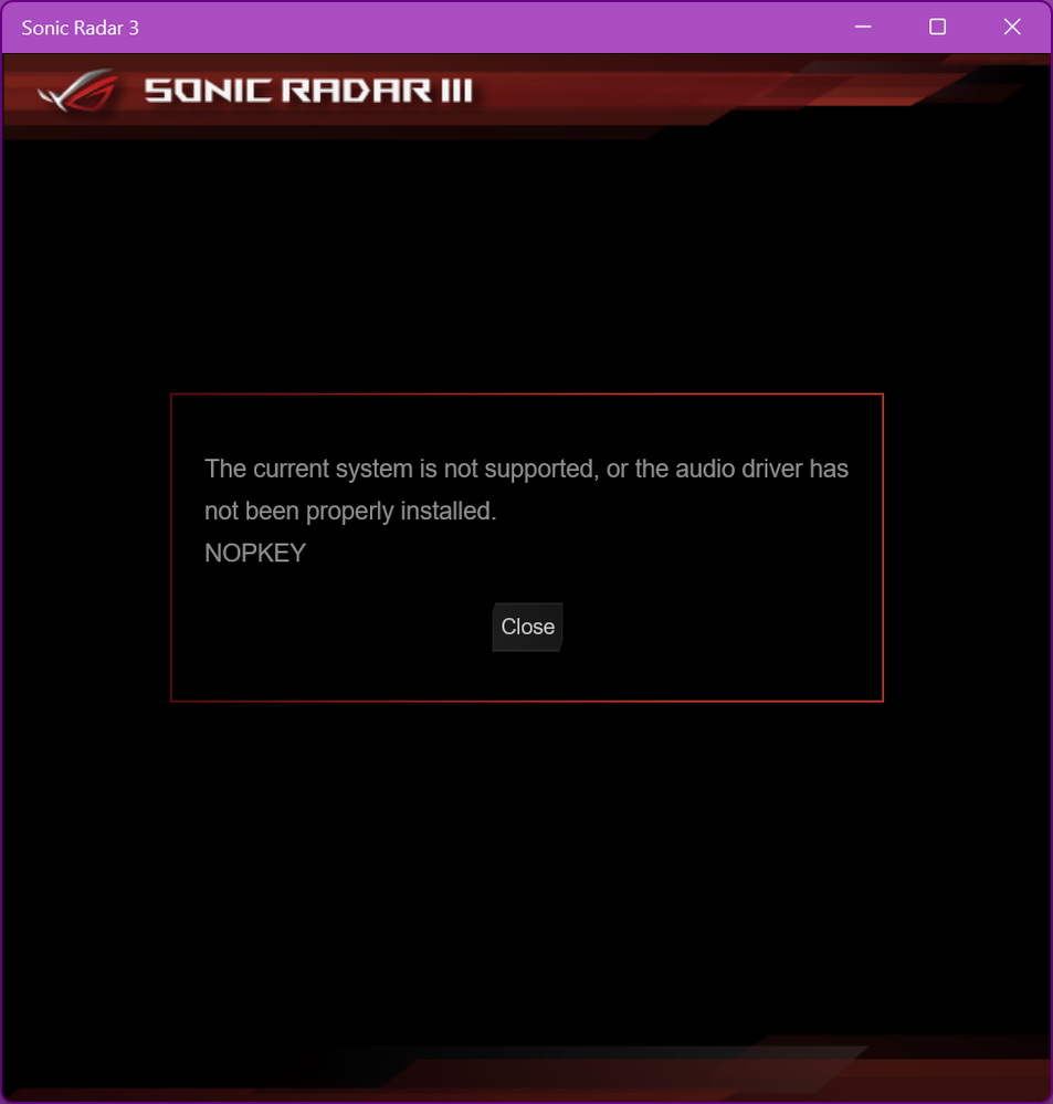

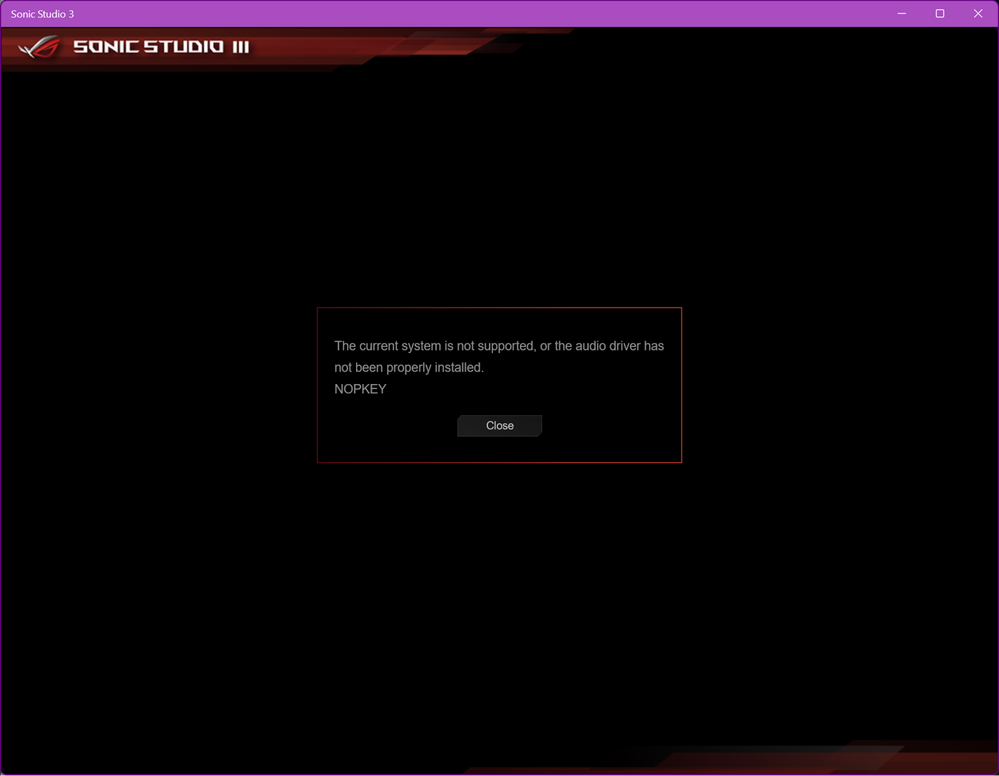

I have a Z790 Maximum Extreme
After months of back and forth with support I am tearing my hair out. The driver package doesn't fundementally work. By default when installing DRV_Audio_RTK_USB_CNT_DTSP_TP_W11_64_V6396002342_20221013R from the full download package it results in:
a) all sonic studio apps giving the "the current system is not supported, or the audio driver has not been properly installed. NOPKEY"

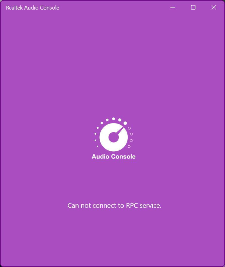

b) the Realtek audio console app doesn't work with the error "could not connect to the RPC service" (if the apps get installed at all)

edit: Hmm could b) above be caused by the fact there is Realtek Audio Service installed in services - if so it seems the installer forgot to install that....

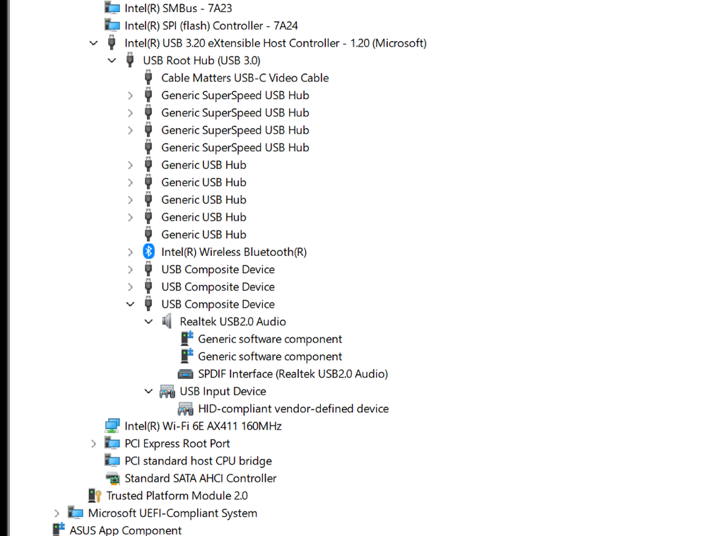

To get everything working I have to 1) for the right driver to be installed for the USB device and 2)process EVERY 3rd party and realtek inf file by hand.
To be clear this is the order of operation after running install.bat and waiting for it to complete:
1) change the device Realtek USB2.0 Audio to use the driver from .\DRV_Audio_RTK_USB_CNT_DTSP_TP_W11_64_V6396002342_20221013R\USBAud\Win64\RtDUsbAD_asus.inf
2) right click all inf files in each of the folders under .\DRV_Audio_RTK_USB_CNT_DTSP_TP_W11_64_V6396002342_20221013R\USBAud\Win64\Realtek\ and choose install
3) right click all inf files in each of the folders under .\DRV_Audio_RTK_USB_CNT_DTSP_TP_W11_64_V6396002342_20221013R\USBAud\Win64\ThirdParty\ and choose install

Issue b) is 100% caused by the service not being installed (i can correct all my issues by manually clicking EVERY inf file in 3rd party and realtek folders and saying installe)
Pictures of what system looks like after running install.bat as admin (as you see wrong driver is device manager)

Sonic Studio won`t start correctly.
Normaly with " No Driver or Soundcard, Timed Out" Message.
So i Tried this stuff install the .inf Files per Hand.
I thought it would work but it`is the same as i would "repair" or Fallback in Windows App.
First Time it says "base Mode doesnt Support" then if i try again Timeout error.
I am using Win 11 Pro 10.0.22000 Build 2200
Rog Strix B650 E-E Board with Bios 0421
