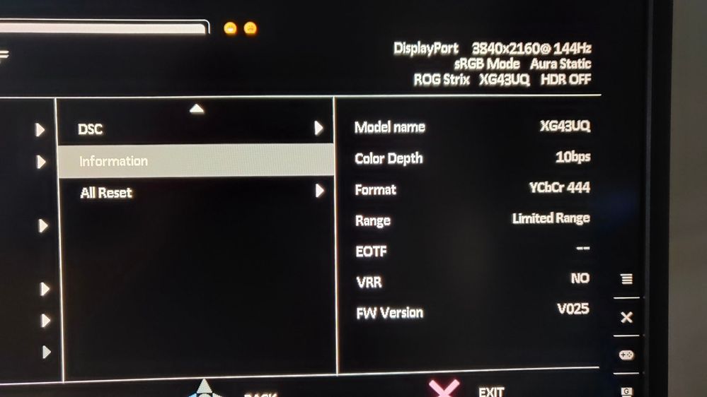

3. the photo of OSD menu settings(in the upper right corner)
89814
