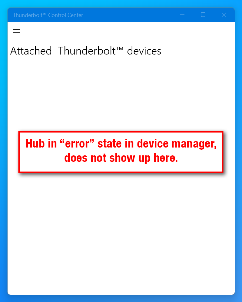

Hub not showing in thunderbolt control center. In this state, USB 3.0 devices connected to it do not work, only USB 2.0 Devices. This is also when there is the yellow error icon shown on PCIe #5 in device manager.

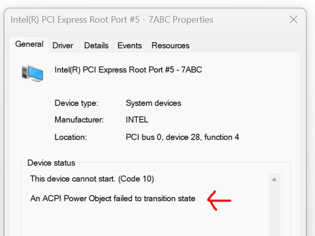

Showing the PCIe #5 device with the error. Showing the device instance path, which you will see is mentioned in the windows error log as causing many WHEA event 17's in the log.
97872

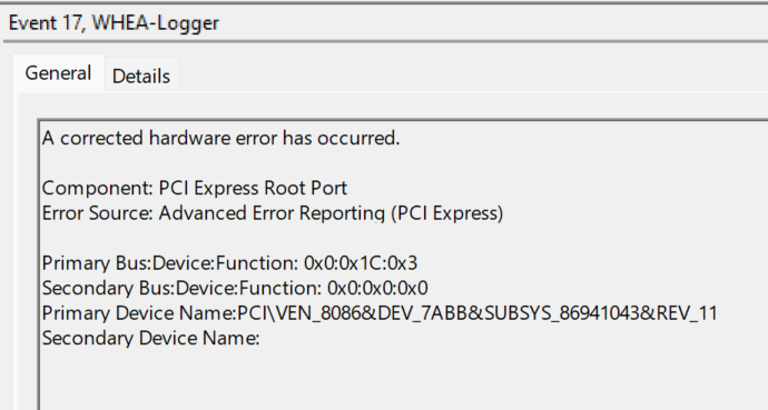

Many WHEA-Logger event 17 entries occurring every few seconds continuously
97875
Info shown for one of the WHEA-Logger event 17 entries
97876
Details shown for one of the WHEA-Logger event 17 entries

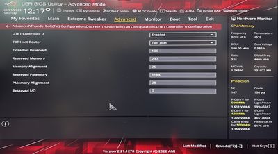

Hello

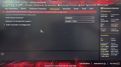

Thanks Jiaszzz@ROG for replay, but not working. My bios settings and thunderbolt application
Retired
Not applicable

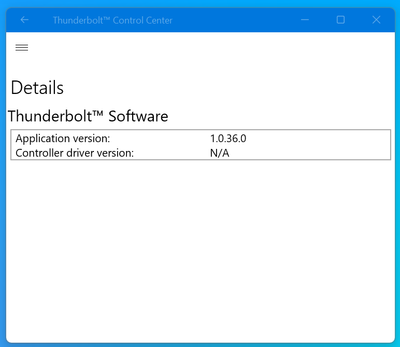

When Thunderbolt Working - Thunderbolt application

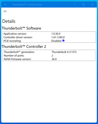

I will also add some more screenshots in addition to my previous post above. I will point out one strange thing, which is in the "About" tab of the thunderbolt control center, it says PCIe tunneling is disabled, but I have it enabled in the BIOS. Not sure if that is related or a red-herring.
About page in non-working state:
About Page in working state:
 BIOS Settings for Thunderbolt menu.
