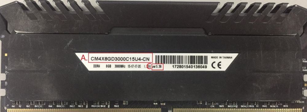

For Corsair ram, could you please help to check the version of your 2 ram kit like below?
95882
Thank you.
95882
Thank you.

Version of the Corsair Dominator DDR5 shows 3.43.01
Thanks again for all the help!
