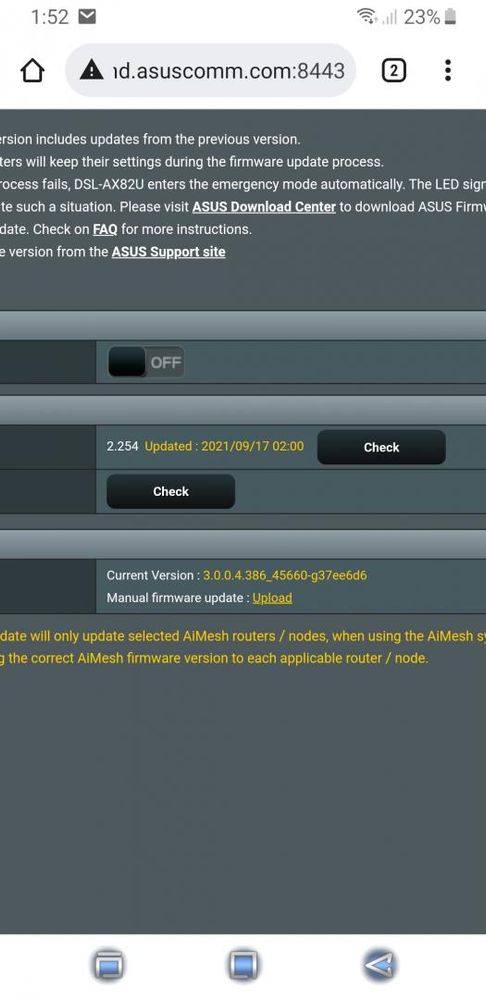

Hi all,
I recently got myself a DSL AX82U. First signs all was great, did notice 1-2 things but, Since the firmware update I have noticed vpn is not working correctly. Its ipv4 yet ipv6 is still enabled. So can bypass the vpn. QOS is giving lots of errors and saying failed. Ipv6 is missing files so the log says. Nat type is not working as it was. Wifi conection drops for no reason on 5g. I get reports too that my dsl is not responding as it should, yet all setting are correct. Alexa is now not reporting any security. Loging in to the router the cert is not always secure. The fact to use alexa I need open router the the net for remote login.
I feel a bit let down thinking this device is new I should not be getting these problems. Also all your online guides are out of date.

Hi TrebleTA,
May I double confirm the firmware version is 3.0.0.4.386.45660?
What kind of VPN do you use? and What is Alexa? Is it an app?

Hi thanks for the reply, sorry think this would be posted on rog routers.
The version I have is Lastest Fw
90182
I use a OpenVPN ipv4 not many are ipv6 so enabling vpn needs to block ipv6 traffic I would think yet sure last FW it did.
