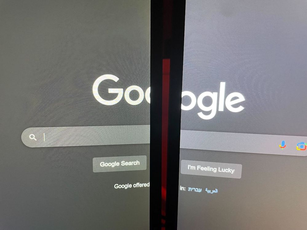

1. Here you can see the backlight bleed. On the righthand side of the left monitor there's an extreme backlight bleed that was not present before the RMA -
97252
And a closeup -
97253

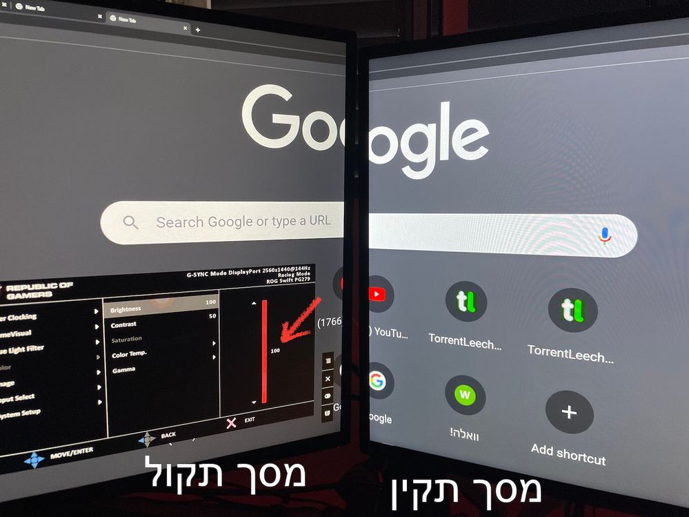

2. The peak brightness issue. This is a bit harder to demonstrate in photos, but you can see that when both monitors are at 100% brightness, the left one is significantly darker (I reset the rest of the settings for both monitors so it's not a matter of colors or anything else).
97254

Jiaszzz_ROG
Customer Service Agent
Hello, everdreamz100 .
Thank you for the comparison image you provided.
I have started to confirm your case with the relevant departments, and I will leave a comment or PM you once I receive any updates.
