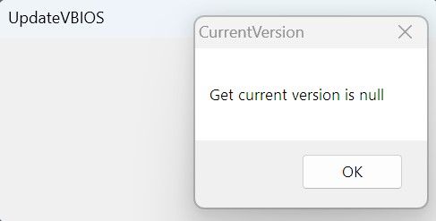

Am having a problem updating the vbios of my strix oc 4090 to V1 that was published on the 24th of Oct on the 4090 strix oc support page - after executing the vbios update file, i get this error "Get current version is null". I currently using windows 11 22h2 with 7950x and x670e extreme mobo (bios 0705). does anyone know how to solve this problem?

has anyone found a fix for this? I'm getting the same error message when trying to update the bios.
so far no direct solution - its either manual flashing (which can have warranty impacts) or we wait for official solution by asus

If I extract the official file from asus I can see the roms to flash in there, why would flashing an official firmware using nvflash void warranty?
they are using the same nvflash tool -- youll see it in the package -- however -- what if something went wrong in the manual process? you did the mistake -- warranty is gone. if you know what you are doing, i guess it would be ok
I ended up doing it for both performance and quiet mode and it fixed the issue I was having of having 90% power limit. Now it defaults to a 100% even when I restart.

same issue here

Has anyone contacted ASUS about this issue directly? I will contact ASUS support directly seeing as this has not been resolved yet and noone from ASUS has addressed this post at all which is pretty important considering how expensive these cards are and the fact that the vbios update can directly affect their performance.
I have a ticket opened with them about it. I know the bios they released on their website fixes the issue but the .exe that it gets downloaded doesn't work. I also mentioned that through an email. I've only heard back from them once but with no details. I just wish they would fix the .exe from the website so we can flash the bios and fix the problem. We need more people contacting them to hopefully make the process faster.
