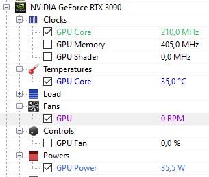

Gielz wrote:
New bios works great here;
86526
what software is this? 😄
Open source program called https://openhardwaremonitor.org/
