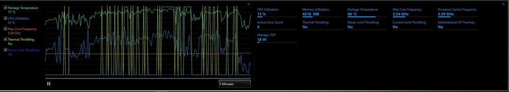

I recently bought a G703VI and I'm having some trouble with performance deficiency issues.
While on idle, CPU seems to be working at about 50 degrees celcius but the strange thing is it jumps to 80 degrees for just a second and then falls down to its normal state as nothing happened. My initial guess was that it was just caused by a glitch, but gaming and some monitoring shows otherwise. While gaming, from time to time I notice a fps loss which lasts about 1 or 2 seconds. I checked the CPU usage and temps with XTU and thermal throttling was spiking like crazy. I tried undervolting about 0.005-0.01V but the problem still persists. I maxed out the fan speed to observe how CPU temp will react. Apart from a few degree decrease, it still hits 97-98 celcius randomly. I've attached the weird screenshots I took from XTU while gaming. Could it be because of a faulty BIOS? Or is it a hardware problem?

I think you are right!. Here are the temps while on Overwatch. I may not be able to do it myself as I'm afraid I might screw things up. Do you think warranty will cover this?
