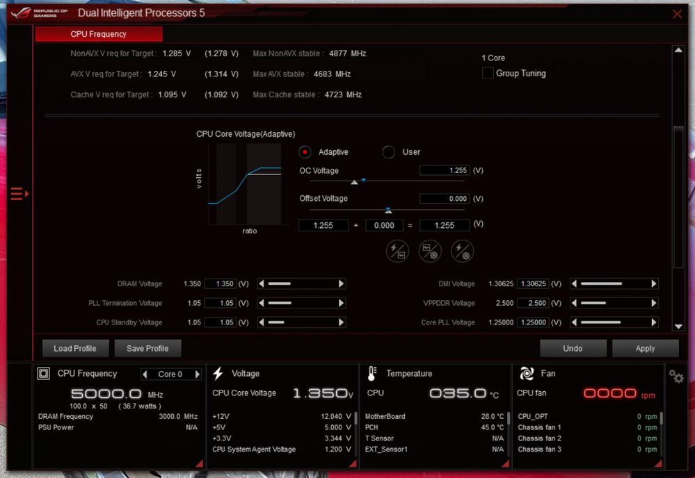

Are you sure you can't configure adaptive voltage? The YouTube video from ASUS on OCing the Maximus XI specifically mentions it, and I know I'm using it.
Screen from DIP5
