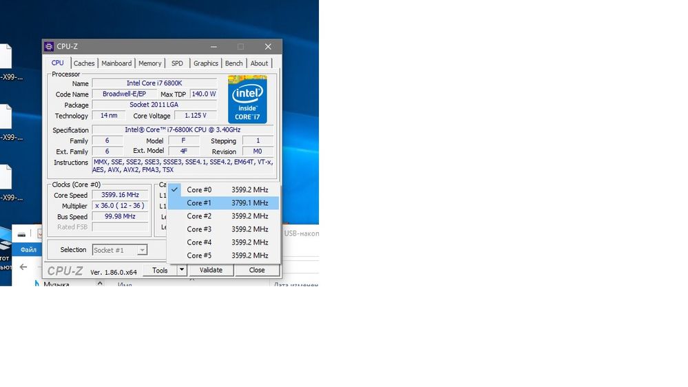

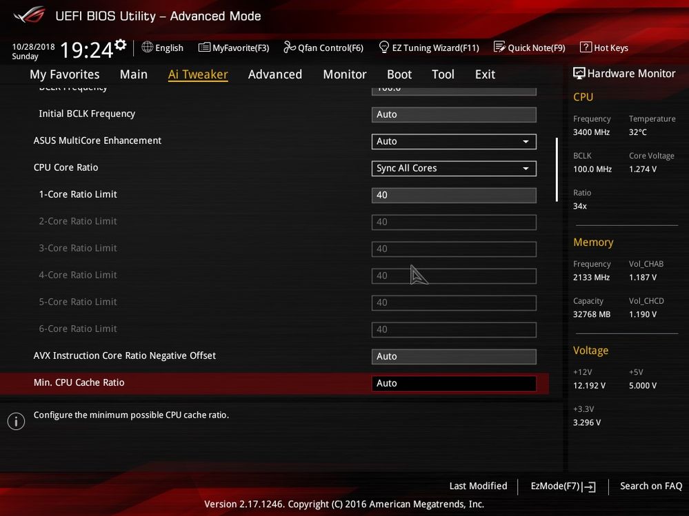

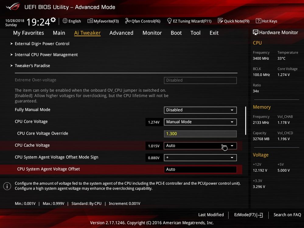

Hello. 2 years ago I assembled a PC and immediately overclock 6800k 4.2ghz. Everything worked fine. After came the new Bios 1802 and beta 1902. I installed them. Now decided to overclock 6800k. I go to Bios and set the multiplier 42 and volt 1.3 save F10 restart windows. I go to GPU-Z and there are 3600 max and 1 core 3800 ... recoverry bios on 0601

Hi, if you are running the latest build of Windows 10 then this is due to the microcode update in KB4100347. If running RS4 (17134) it's possible to remove the offending patch and disable updates. Should be firmware updates sometime in the near future.

Hey guys,i have the exact same problem as Love66!
The only difference is,though, that i don't have this particular update on my pc (currently running win10-1709 version) ,i checked at the update history and couldn't find any update with this name KB4100347.Any overclock above 36x doesn't work and only at core 1 g ives 3799mhz...
