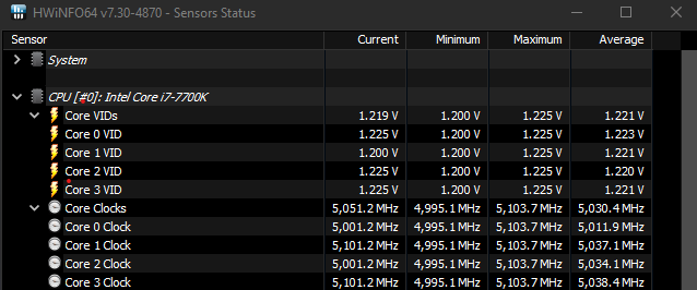

With this configuration I passed a one hour OCCT (AVX2) test without any problems, but I noticed something odd with the clock reported by HWiNFO64.
When the system is in idle I have noticed that the core clocks keep jumping between 5.0GHz and 5.1GHz, sometimes all are at 5.1GHz, other times all are at 5.0GHz, and some time some are at 5.0GHz and others at 5.1GHz.
95989
Then when I started a stress test (OCCT - AVX2) all cores were always at 5.0GHz, they didn't touch 5.1GHz even for a moment.
Can anyone explain to me what is happening?
I would have expected core 0 to be fixed at 5.1GHz and all others at 5.0GHz, why the clocks keep jumping between 5.0GHz and 5.1GHz?

The clock speeds are fluctuating due to how much load is being applied to the cpu, I do see they hit 5.1GHz as the maximums are showing. To get the cores to run at a constant overclock, set the windows power plan to high performance.

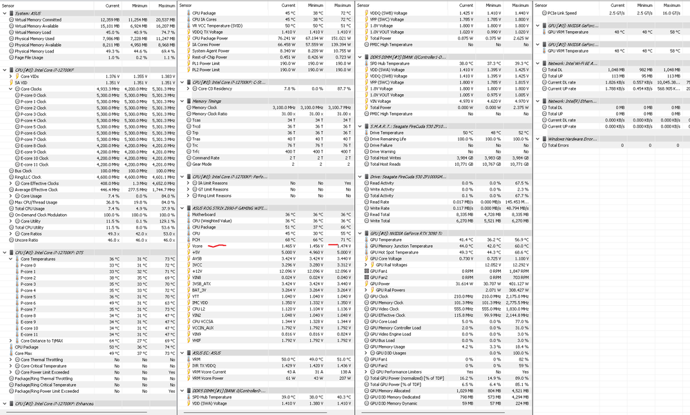

Yes voltages are correct, I also use HWinfo.
I used Thermal Grizzly Conductonaut between the die and IHS, Kryonaut between the IHS and water block, liquid cooled with the Koolance ERM-2K3U cooling unit.
I saw a -15c temp drop delidding my 7700k.
If you used similar and have good cooling, temps shouldn't be much of a problem with 1.45v.
I'm using the ROG Strix Z690-F Gaming Wifi with the 12700KF overclocked to 5.3GHz with 1.47v.
Here's a screenshot of HWinfo, click the pic to make it bigger.
95991
