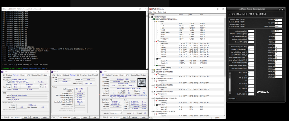

Here is a previous venture on the Maximus Formula (Z390) for 4x8GB 4266 GSKILL. This alone required some concessions to tertiary timings to find stability.
VCCSA is CPU specific and too much voltage can hurt stability just as much as too little, so tune accordingly.
