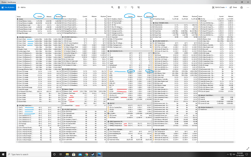

Click the pic to make it bigger, then again to make it clearer, blue is cpu, red is ram.

When I delidded I replaced old paste with the noctua n1? That came with the cpu cooler. Running cyberpunk medium ray tracing and highest temp after 2 hours of play was 72 and that's with watching a stream on the other monitor. I'll post hwinfo after your adjustments. I also used user benchmark which showed everything was pretty solid but the ram was somehow real bad? But I thought I had a good ram so not sure of a setting for that. I can't figure out how to post the screenshots from user benchmark but can't?

So im able to bump the CPU Core Ratio Limit to 49 and 1.3v and its stable, other than the iffy ram which in bios it says 2400mhz 1.2v but should be 2666mhz 1.2v. but if i enable xmp mode then it says 2666mhz in the bios. I tried changing from 49 to 50 at 1.3v and blue screened after windows icon, I increased volts to 1.31 1.32 and 1.33 with same bluescreen. Wasn't quite sure how much to increase it so figured good time to update here. But at 49 and 1.3 everything in hwinfo is running prime. cpu is basically at 88-100% usage at all times while running cyberpunk medium ray tracing @1080p with a stream or youtube video on the other monitor.
