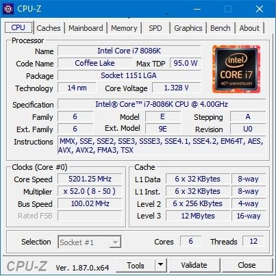

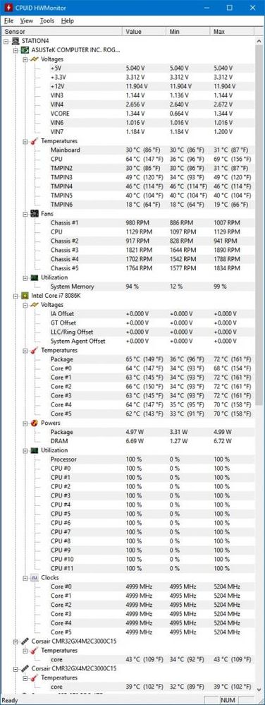

Hi,
Hopefully, this will help.
References I used (there were a few) are listed at the end of the post.
Overclock settings for i7-8086K on Asus ROG Maximus X Hero (WiFi AC) [BIOS v1801]
Final settings saved in Profile 1:
1.33v cpu
52x all cores
3.1Ghz RAM
46x uncore
LLC=6
Profile Name: 133c52r31u46L6
CPUID HWMonitor:
Intel Burn Test v2 uses AVX and thus lowers CPU core ratio by 2 (AVX Offset = 2) for core ratio of 50 instead of 52. CPU then runs @ 5.0Ghz instead of 5.2Ghz
79445
CPU-Z:
79447
Note: As some BIOS upgrades wipe out all saved profiles from the motherboard, will need to save notes on settings used for best OC and other profiles somewhere else for future reference.
