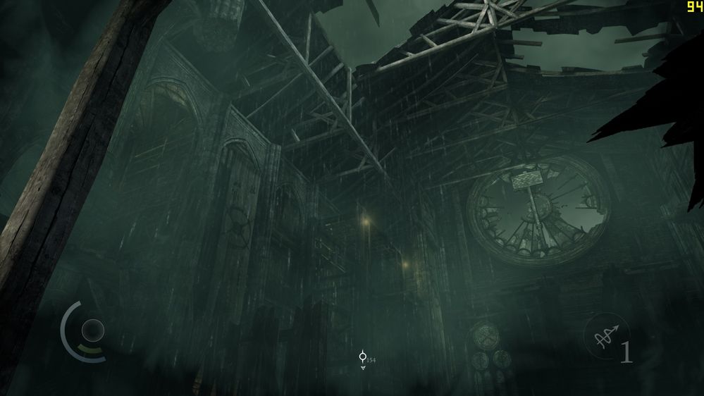

Just upgraded to an R9 280x but have come across a problem, this is happening in a few games (see below) the temps are not an issue and i have tried the latest/beta drivers with no changes... Sometimes it is there after 5 mins some times it takes an hour...34886

Sincerely, I have no idea what's wrong with that picture... I don't know how it should be...
I assume that the above picture is from a game - this Forum has a special section for gamers, maybe you can look there... maybe you just have to find the right driver/settings for your particular game...
no it moves around on the right side of the monitor, only happens in thief and sniper shost warrior... it changes shape and size... Ran furmark for a few hours and all was fine...

34887 - It does it in a few games when looking around... Cheers thou

Is it always there, in that position or it shows up in other places on the monitor too?
If it's always in that corner, it actually may be a monitor issue...

I see, then it's the graphics card... - most likely the driver...
You have said "Just upgraded to an R9 280x" - what was your previous card? Have you deleted the previous driver correctly? If you were using an Nvidia card before, you may need to completely re-install the whole OS...
Robthedestroyer
i thought that so i formatted my machine and started again... still happens
