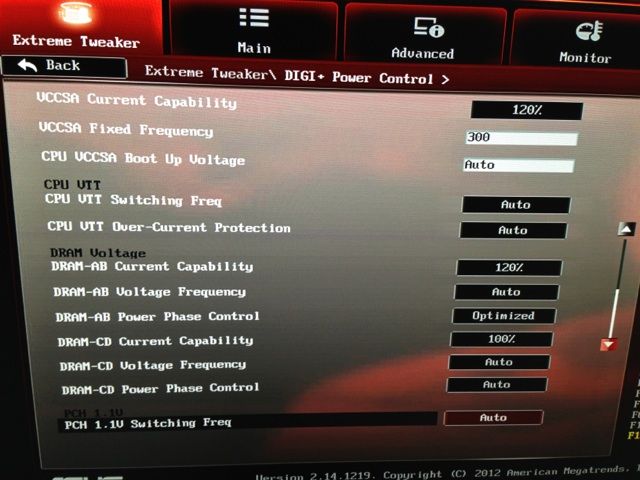

First, I want to say thanks to everyone who has been giving me advice.
I've been trying to find that sweet spot for stability, but it has eluded me. I have lasted longer this time with out a freeze and I feel like I'm finally getting somewhere, but I need some advice.
Could some kind soul take a look at my setting and let me know where I messed up? (lots of pics)1374213743137441374513746137471374813749

Your DRam voltage is way to low. Please increase the voltage so that it is at least above 1.500, however I would say that 1.65 is the suggested voltage by GSKill for that frequency.

Thanks!
I'll bump up the DRAM voltage and see it it does the trick.

Other things I spotted...
Put yout Tweak mode to 1 in DRAM timing section.
Have your DRAM CD voltage same as AB and also change current capability and power phase to same values as for AB (120% and optimized)
I would also get your LLC down to Medium. You are running at stock with that multiplier so I would leave the CPU voltage at Auto and enable speedstep. a manual voltage of 1.365 is high for 3.8 GHz. The boot up voltage I would leave on auto.
Keep it as simple as possible 🙂
Thanks Arne I will give those settings a try.
