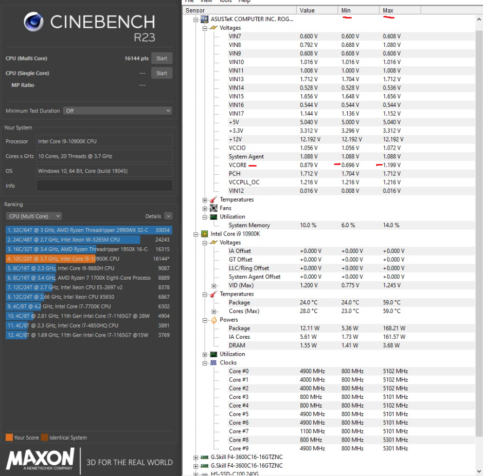

Hi. Yeah I know that is why I am trying V/F point offset instead. See the last image for voltage and temp readings.
I am trying to reduce power consumption without losing performance. Thanks.

Your minimum and maximum voltages look good, if it's BSODing at idle with more offset, it's a sign you may have reached the idle voltage limit.
10 cores at 5.1GHz with a maximum of 1.199v is very good, cpu package temp shows a maximum of 59c, again very good.
Idle voltage at .696v looks good, because of 10 cores you may have found the limit.
So, what I think you're trying to do is to see if you can get a lower maximum voltage while under load.
Does trying LLC at 0 or 1 give you a lower maximum voltage, and is it stable?

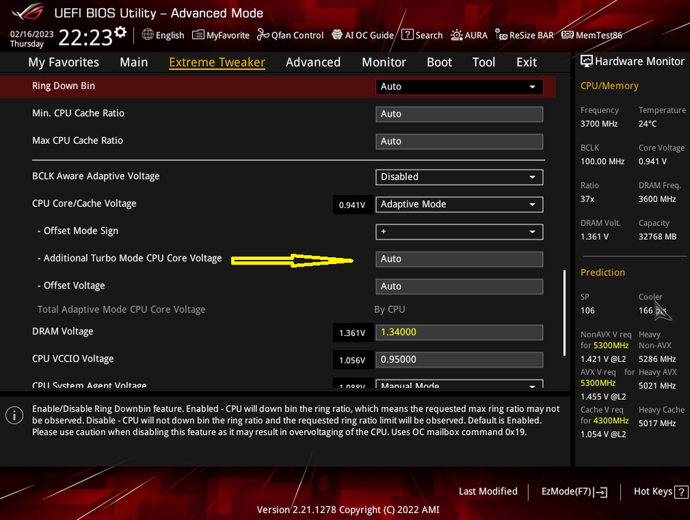

You could manually enter in say 1.195v - 1.190v in the "Additional Turbo Mode CPU Core Voltage", set LLC to level 4. If you're not already at the lowest maximum voltage for 5.1GHz, you're awfully close.
Best case scenario should help keep the maximum voltage close to what you set in the bios, LLC affects maximum voltage too. The goal is to have the maximum voltage the same is what you set in the bios.

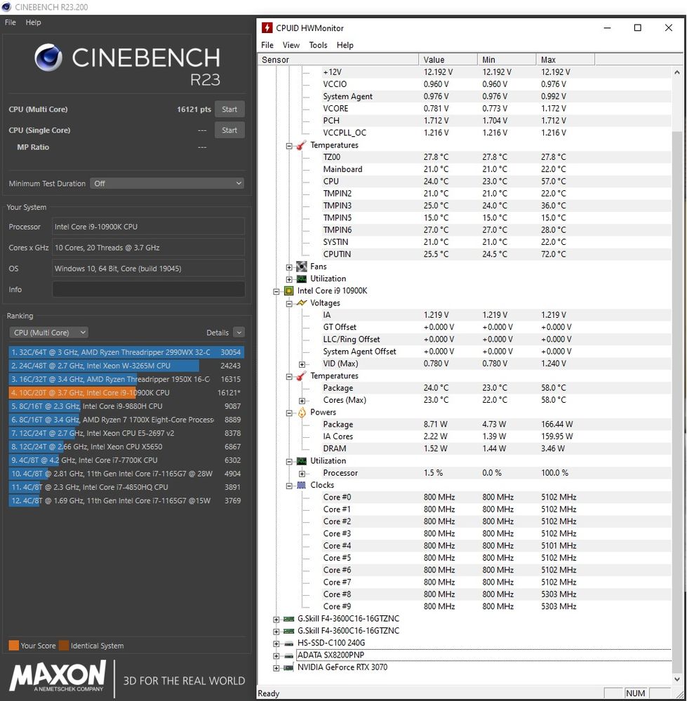

Tried 1.190V "Additional Turbo Mode CPU Core Voltage" while LLC is 4 but power consumption and temperatures are increased. After that reverted LLC back to 2 with the same additional turbo mode voltage and I got a better result.
97350
