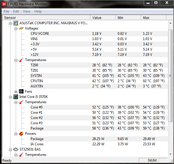

you got it! that'll be my specs guess ill have to edit my sig-specs then, the thing is im running on a bench.. no not actually a bench its a box, tthank you for your never ending help bud though i've noticed one thing its not the cpu itself here take a look
ive left it on since i was gaming what the hell is CPUTIN?

Oh, yes the HWMonitor... I was hoping, while I'm switching from the Rampage series mobo to the Maximus series that HWMonitor issue would disappear... well, it didn't happen...
On the Rampage mobos the AUXTIN and CPUTIN things were reported incorrectly (I mean, they're still are)... it seems that on Maximus series too... (I observad that on my MVG too)... just look on your picture - do you think that AUXTIN at 2C is correct? what's your ambient temp? (you know that your temps can not go below ambient, right?) just disregard that! focus on the core temps...
On the other side, 40C at idle is still hot! again, what's your ambient temp where you're running that system?

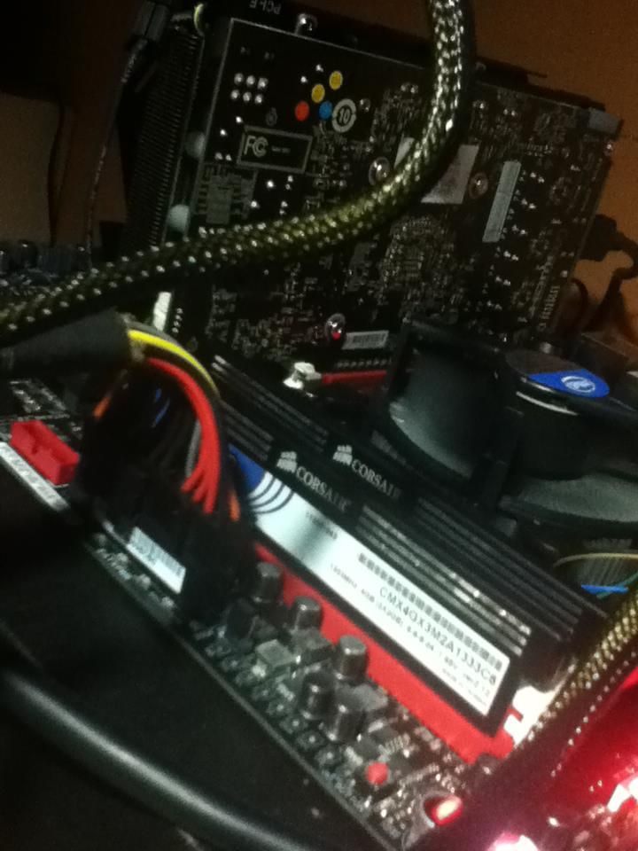

today its around 25 since its rainy here, my best bet would be that it is the stock fans, the heat sinks are so little now compared to 775 stocks
on extra note ive rebooted just to make sure it's now around 36-38 on idle
just look at the sink my ram is slightly taller than it
