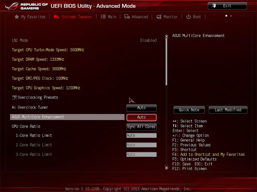

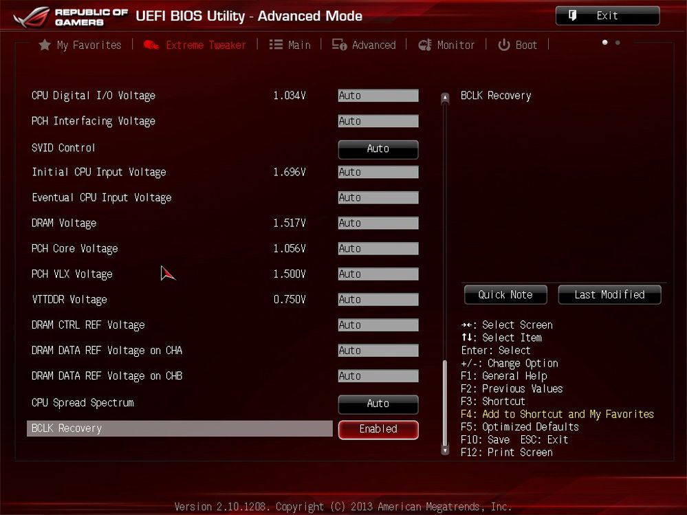

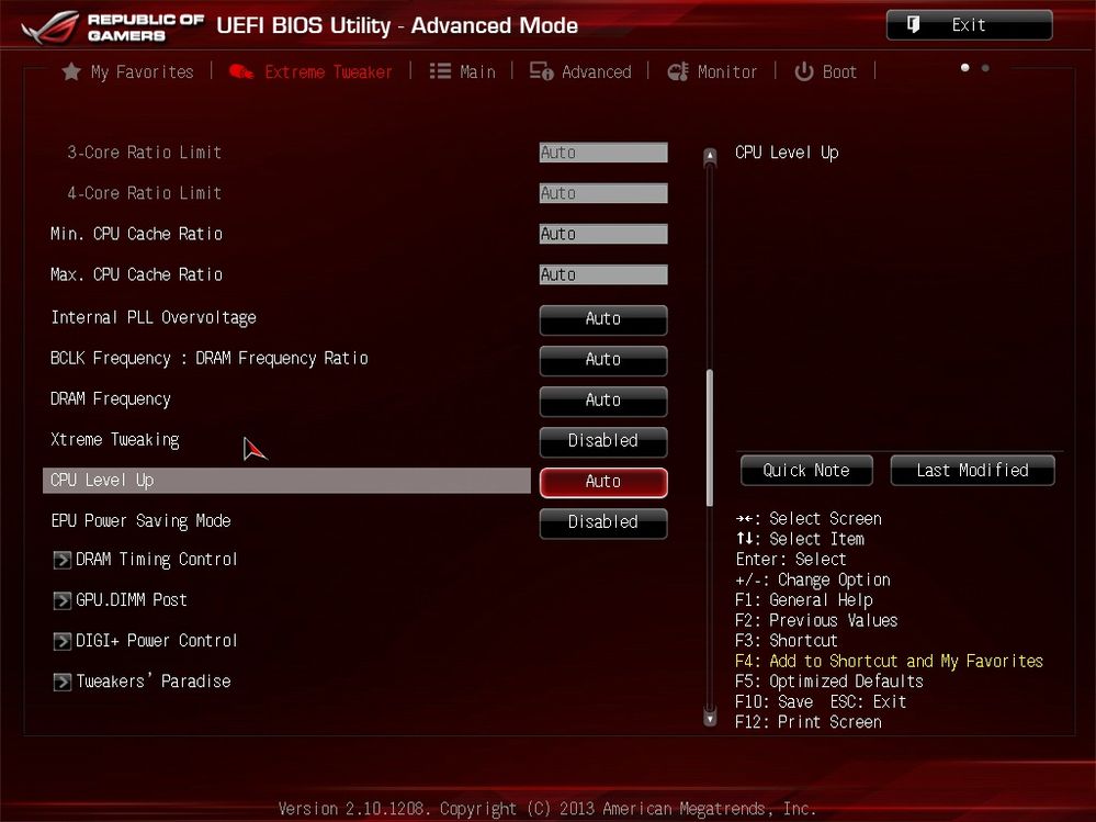

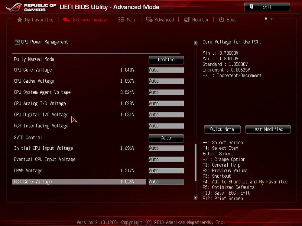

Thanks for the help. I have uploaded some screen shots.
25983259842598525982
ASUS Maximus VI Formula | Haswell i5 4670K | ASUS GTX770 DCII OC Edition | 16GB Corsair Vengeance Pro | Corsair HX750 | Samsung SA950 120Hz | Samsung SSD 840 Evo | Fractal Design Define R4 Black| Noctua NH-U14S
Chino
Level 15
Everything looks in order. The only option that kind of falls out of place is the CPU Core Ratio. I think it was on Auto by default.
