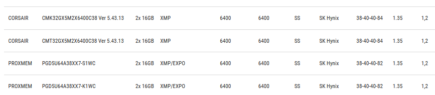

Hi @Akumasama, these do not appear to be on the motherboard QVL, which means they have not been validated by ASUS.
Please note that when XMP/EXPO is enabled for the first time, the system may take 1-3 minutes to complete POST whilst memory training takes place.
Try reducing the frequency to 6000MT if the system refuses to POST.
