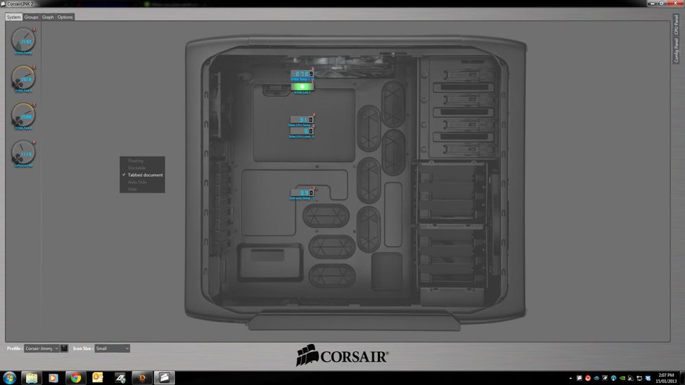

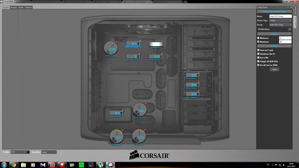

I have started to get the OC bug, but am only in the beginners area; however, I recently purchased a Corsair H100i.
My question is in relation to the monitoring software. Corsair LINK 2.
It displays the CPU temp, and my GTX 680's temp, but where do the drive 1 and 2 temps come from, and how to I either connect them if able to, or disable them???

Just to give you an idea how thinks works in the link, the drive temp refers to HDD/SSD temp not likely you can disable

Well I have both an SSD and a HDD and it was not showing any temperatures for it.
Anyway, I just solved the problem by right clicking on the HDD icon and it gives you the option to hide.
Am going to go with the reply above as I am going to experiment with OC

JimmyH
Level 10
15914
Now there are no drives visible.
V3ND3TTA
Probably your drive didn't support temps may be no sensor i do have a drive that didn't show as well
