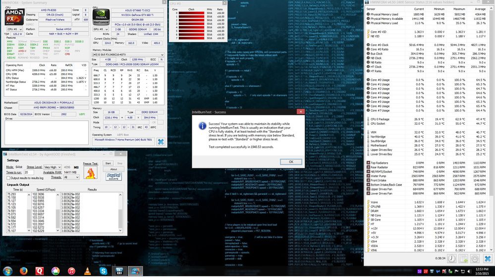

I did see why it wouldn't. My Tridents have slightly higher timings. This is what I run daily.
