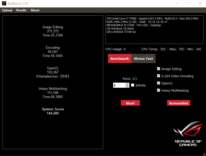

Personally, I'd ditch prime95 and install ROG Realbench, then I'd set AVX offset to 0 and the cpu should stay at its overclock. Realbench puts 100% load on the cpu and isn't as harsh as prime95, you should get better temps with Realbench too.
Care to give it a try? Set AVX offset to 0.
https://rog.asus.com/rog-pro/realbench-v2-leaderboard/
My score with the 7700k
76536
