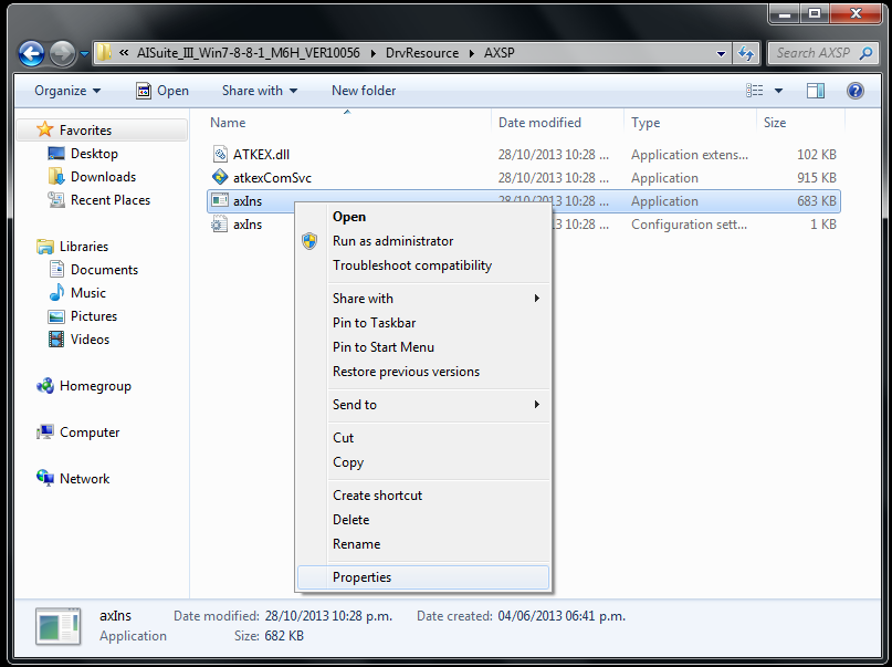

Step 1. Navigate to the AXSP folder that’s in the AI Suite folder. Then right click axIns.exe and select Properties.

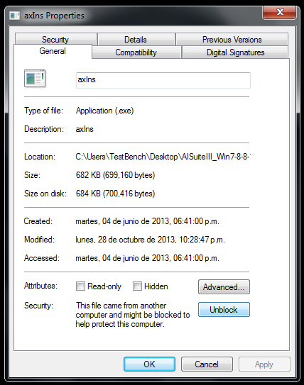

Step 2. Click the Unblock option at the bottom of the General tab.
[/HR]

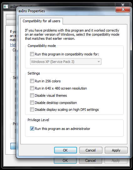

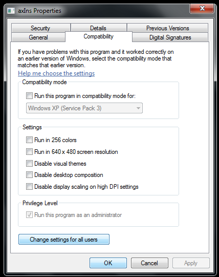

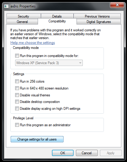

Step 3. Proceed to the Compatibility tab and click the Change settings for all users option.
[/HR]
29497
Step 4. Tick Run this program as an administrator option.
[/HR]
29498
Step 5. Click Ok to apply your changes.
[/HR]
29499

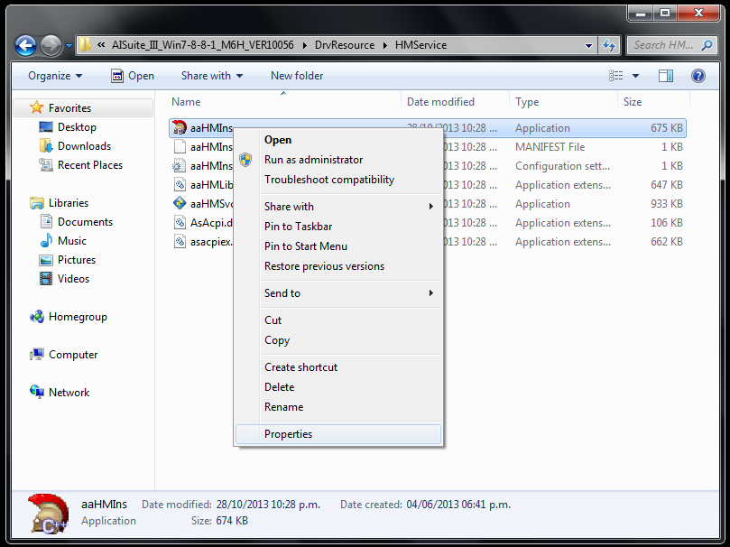

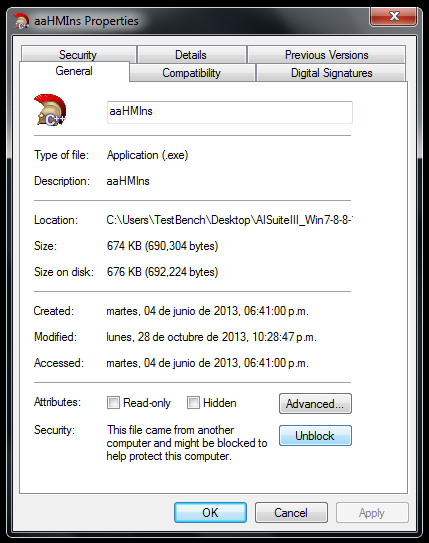

Step 6. Open HMService folder next. Then right click aaHMIns.exe and select Properties.
[/HR]
29500
Step 7. Click the Unblock option at the bottom of the General tab.
[/HR]
29501

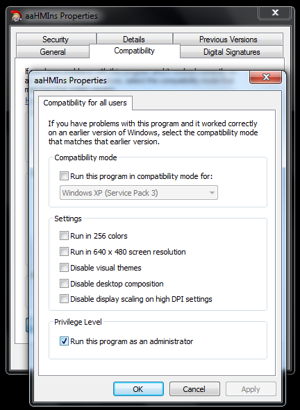

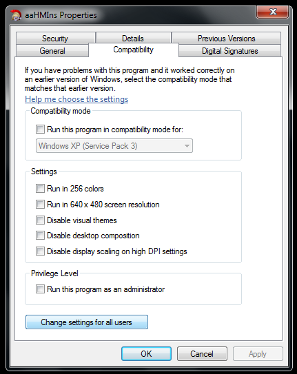

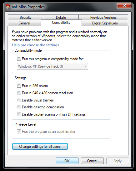

Step 8. Proceed to the Compatibility tab and click the Change settings for all users option.
[/HR]
29502
Step 9. Tick Run this program as an administrator option.
[/HR]
29504

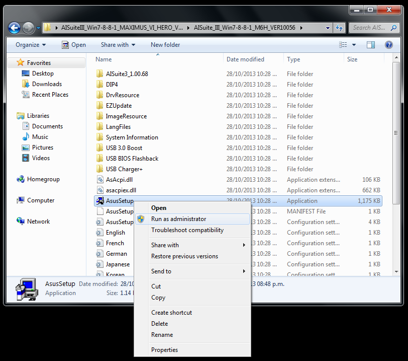

Step 11. Run AsusSetup.exe with administrator privileges.

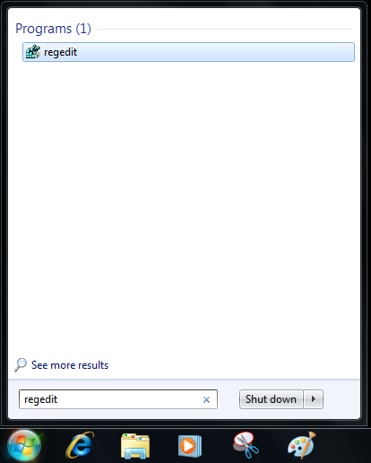

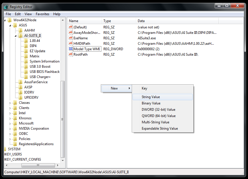

Step 1. Start by opening Registry Editor.
[/HR]
29506

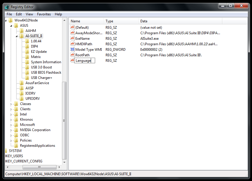

Step 2. Navigate to the following key: HKEY_LOCAL_MACHINE\SOFTWARE\Wow6432Node\ASUS\AI-SUITE_II Right click in the right window and create a new String Value.
[/HR]
29507
Step 3. Name the String Value to Language.
[/HR]
29508

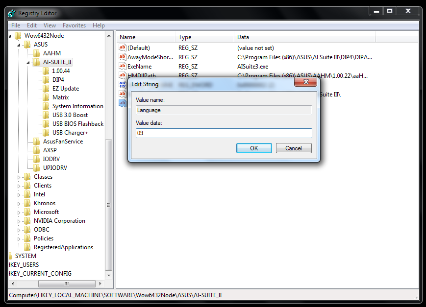

Step 4. Input the value of your language.
[/HR]
29509
Choose from below:

Step 6. Restart your system and AI Suite III will be displayed in your language!
