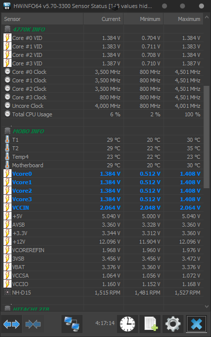

I have a Maximus VI Hero and a 4770k at 4.5GHz with 1.385v manual mode set in the BIOS. I have Eventual VCCIN set to 2.05v and LLC of level 5 or 6 (off the top of my head). I know that LLC doesn't affect core voltage at all and only affects VCCIN. However, under load my Vcore shoots to 1.408v. I was thinking it'd be closer to 1.385v as I know some people with 4790ks whose voltage in BIOS is pretty much the voltage they get under load. It happens no matter what core voltage/VCCIN I set.
Sometimes when my PC is idling, I see my Vcore at 1.384v which is really close to the ideal 1.385v.

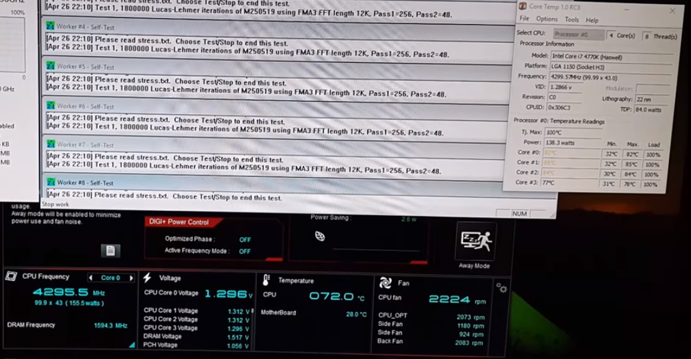

The same happens to someone else on YouTube. They also have a 4770k and a Maximus VI Hero, so maybe this quirk is only specific to those with that combo?
73743
They've set 1.285v in BIOS but actually get 1.296-1.312v under load, which is what I get when I set 1.285v.
https://www.youtube.com/watch?v=F4TUfT_wiLw

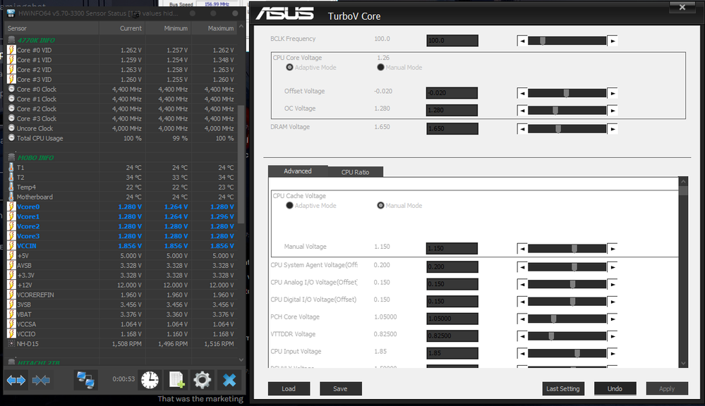

Try setting a negative offset of -0.020v
That seems to have fixed it, but I have to run adaptive voltage, which causes spikes when I run AVX programs. 😕
73748
Still weird how I have to do a workaround while for others, it just seems to work fine out of the box.
