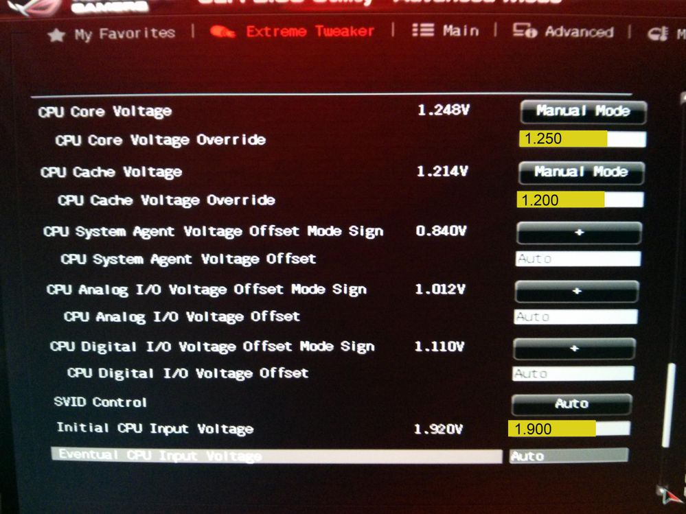

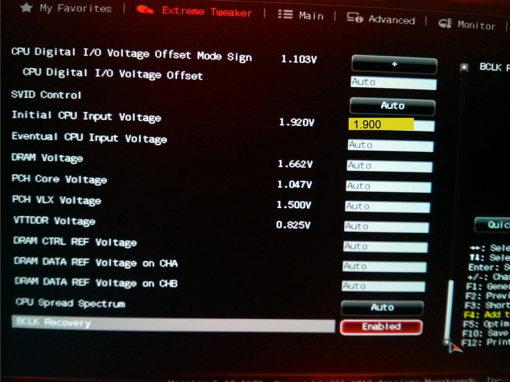

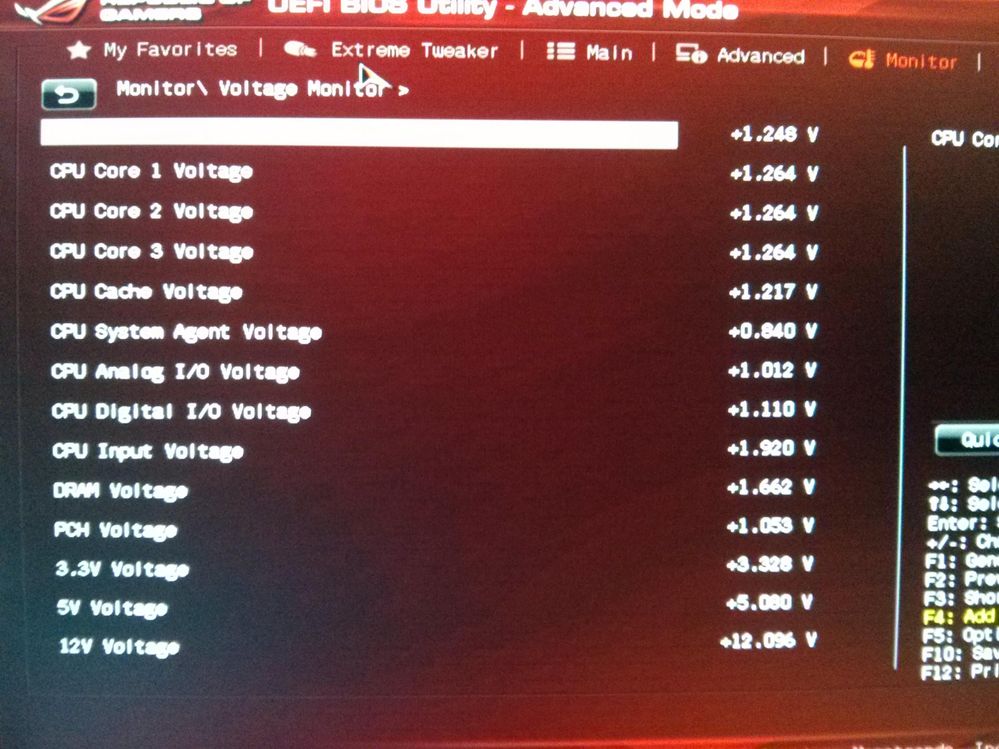

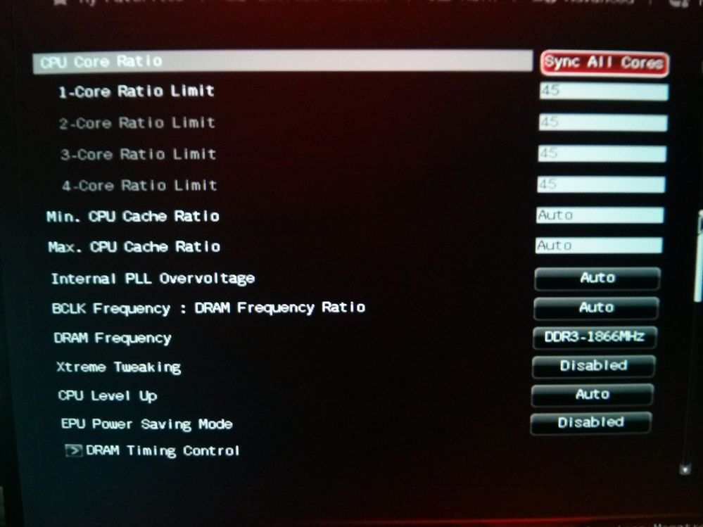

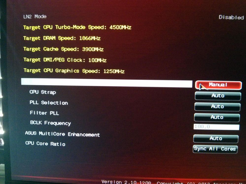

Thanks HiVizMan for the reply. Yes, I have 2 profiles in XMP. 1st one is 2401 mhz and second one is 2399 mhz. I will try the second and will let you know. Attached I put pictures of my BIOS for your reference so you can see my voltages. What voltages do you suggest I change/ modify if profile 2 doesn't work?.....I'm a new to overclocking don't want to mess something up. Should I try 1.260 as my vcore and 1.70v for my ram?2850128502285032850428505

Not sure you knew this but you can take screen shots of your bios. Use a fat formatted USB drive and F12 in bios to take the screen. A nifty little add on.
