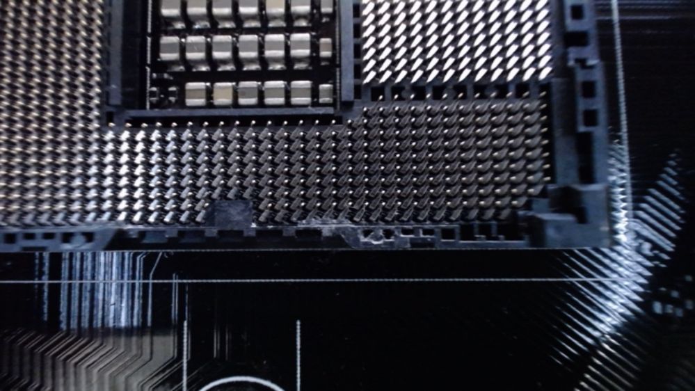

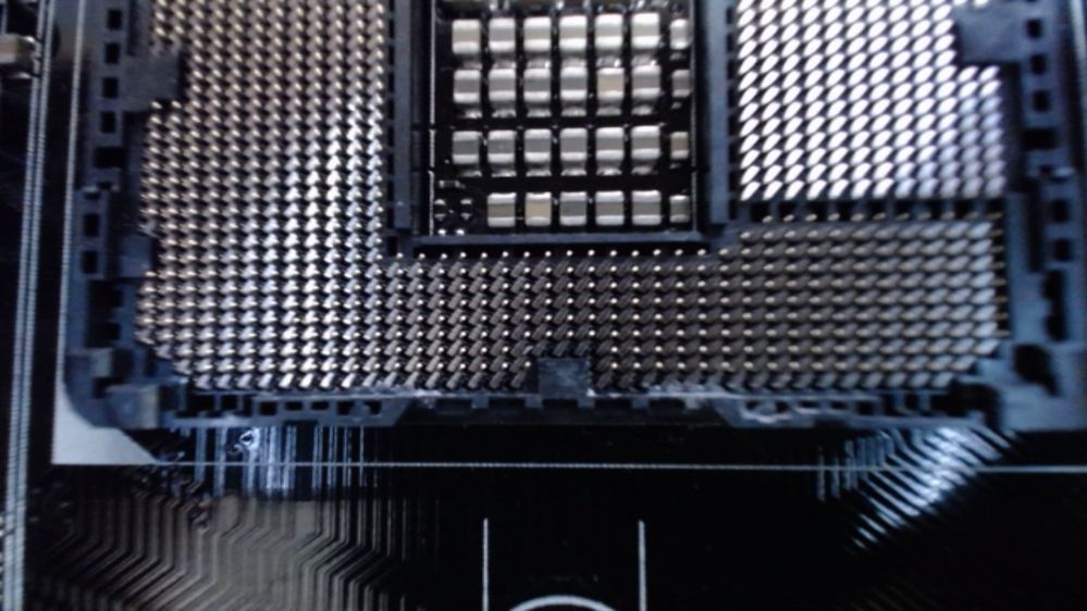

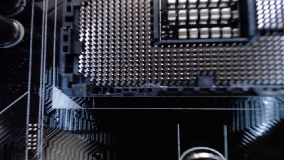

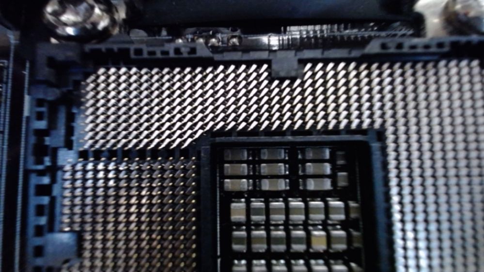

There is some thermal paste in the bottom edge of the CPU socket and also approx 4 slightly bent pins near the top of the socket. Photos on the RMA. Rejected due to physical damage
I agree on the paste, but that's not physical damage - it's non-conductive and it's an insignificant amount.
The pins are not really bent - they're just slightly offset. The CPU works perfectly fine!
They've also attached a few photos (below).

Yes they will charge you to replace the cpu socket and will cost about $150.00 u.s. dollars, you'll have to make the call on getting it repaired or buying a new motherboard.
Since there are only 4 offset cpu socket pins you can straighten them with a wooden toothpick in good light with a magnifying glass which is what I would do, a good eye and a steady hand are key.
