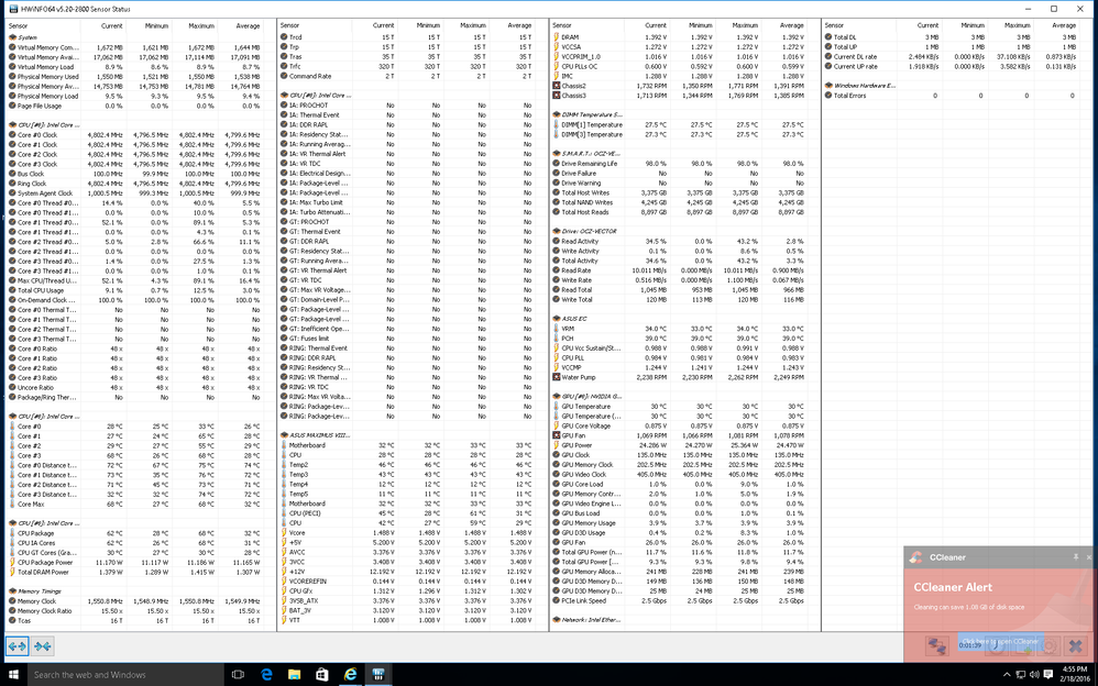

Here's my HWInfo, excuse the CCleaner alert it popped up when I hit print screen. 🙂
55749
Hi Nate, I agree! And this board has been rock solid, other than a few POST quirks I worked out a while ago, and it's running pretty much 24/7.
I notice in your screenshot sensors 4 and 5 seem to be giving odd readings at 11c, but not quite the mess that I'm seeing. Then again, your board is a couple generations ahead of mine so I'm sure things are a bit different.

50c sounds more like it.
Yeah I would think sensor 4 and 5 are false on mine too, 11c is about 51 degrees fahrenheit and it's 74 farenheiht in here. So no way can it be lower than room temp. 🙂
