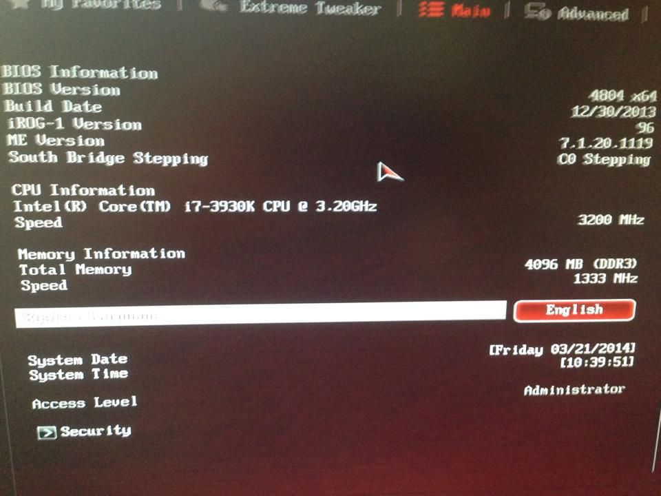

I need some help, my motherboard's temp has jumped to ~120 C this temp appears in both the BIOS and probe II.

Here are some pictures of the bios screen:
3476434765
