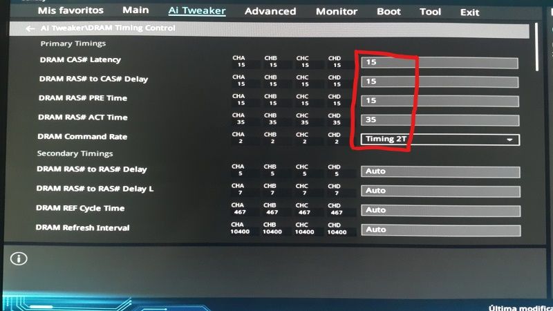

Hello guys I have some doubts regarding the values that should carry my memories in the bios, I communicate with G.Skill support and they gave me some values and I have managed to put some but there is one in particular that I can not find that is the CL Timing.
I also want to know if those are the minimum values for my ram configuration or can I upload a little more?
These are the data they gave me in G.Skill
DRAM Frequency = 2666MHz
DRAM Voltage = 1.20V
CL Timing = 15-15-15-35
Command Rate = 2
The machine I have is:
-Asus X99-pro 3.1
-Intel Core i7-5960X Haswell-E / EP
-G.SKILL RIPJAWS V (F4-3200C16Q-64GVK) 1 kit - 4 modules
I leave some captures to show what I have done.
Here adjust the DRAM Frequency
Here adjust the DRAM Voltage
Here adjust the Command Rate
But the CL Timing does not know where to adjust it, since there are many options
If anyone can help me please I would greatly appreciate it.

In your screenshots above the command rate are the primary timings which is the CL you are referring to.
Above the command rate start at the very top enter in (where it says auto)
15
15
15
35
command rate 2

hi Nate152
Is this how it should be?
63693
Nate152 wrote:
Yes, you got it ! 🙂
Thank you very much, I owe you one. 😄
