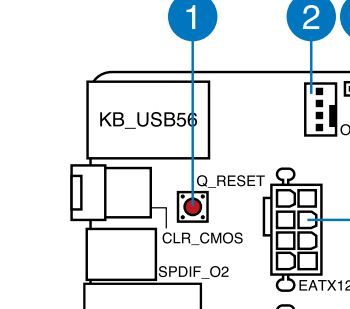

While setting up, I noticed that my keyboard wasn't being recognized when plugged into the USB port(s) labeled KB_USB56.
575
Thinking it was a fluke, I simply moved the keyboard to another connection and continued setting up my system.
Once Windows was installed, I started checking the USB ports, remembering the initial problem. I have since discovered that, in addition to those ports not working, the USB ports via the onboard headers, USB78, aren't working either.
574
I've since updated to the newest BIOS (1301), and even tried enabling legacy control in the BIOS to see if it made a difference. I tried with multiple devices. Interestingly, a USB-lit mouse pad that I own does light up, as do the internal LEDs within my Seagate FreeAgent. So it's like the USB ports in question can supply power, but cannot communicate with the board.
