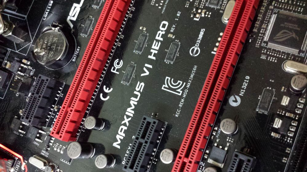

First, you’ll need a Maximus VI series motherboard, of course. For this guide, we’ll be using our Maximus VI Hero motherboard to illustrate the whole setup process. But the steps are universal for the other motherboards in the series as well!

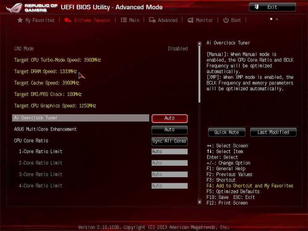

Step 1. Hit the Del key as soon as you see the Asus logo to enter the BIOS. The option that interests us most is the Target DRAM Speed. As you can see, it’s running at its default 1333MHz frequency. Time to take these babies to 2400MHz!
[/HR]
28827

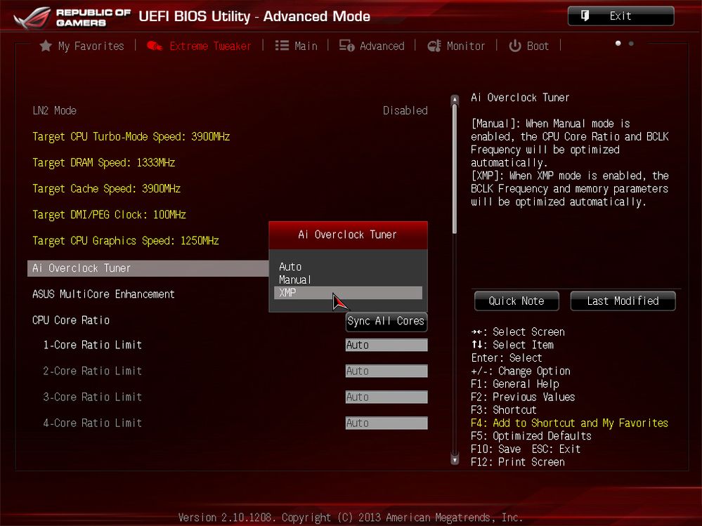

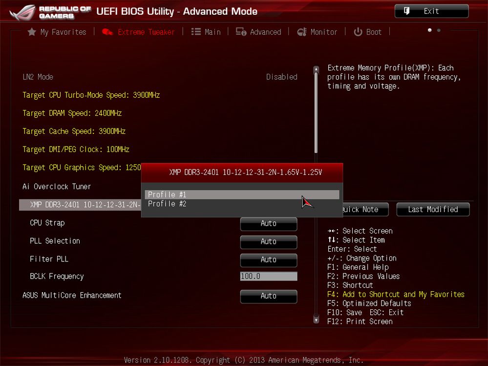

Step 2. Navigate to the Ai Overclock Tuner and change it to XMP.
[/HR]
28828
Step 3. Most, if not all, high performance memory kits like our TridentX 2400MHz kit will have more than one profile. In this situation we choose the one that matches the advertised frequency.
[/HR]
28829

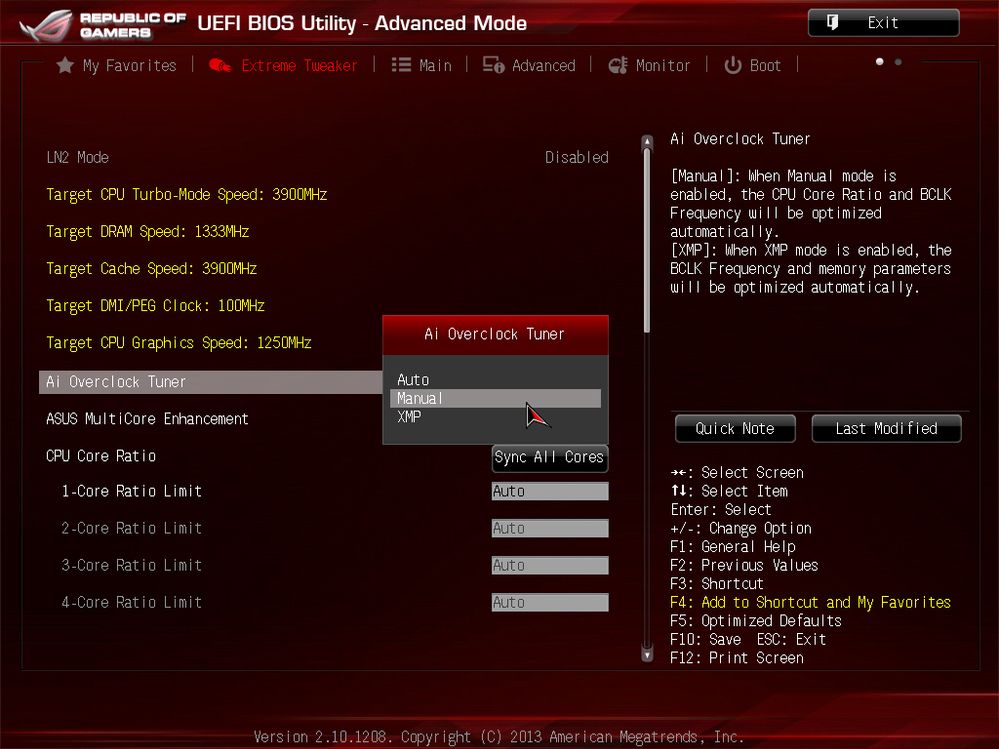

Step 1. Start by setting Ai Overclock Tuner to the Manual.

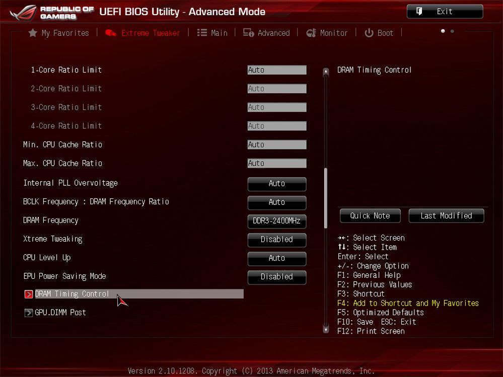

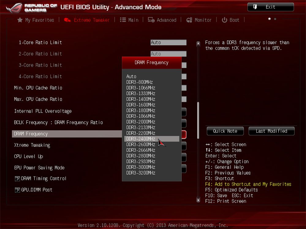

Step 2. Scroll down to find the DRAM Frequency option. Choose the advertised frequency that your memory kit is specified to run at.
[/HR]
28833

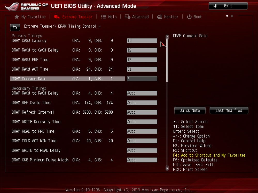

Step 3. Scroll down even farther and click DRAM Timing Control. The fun is about to start.
[/HR]
28834

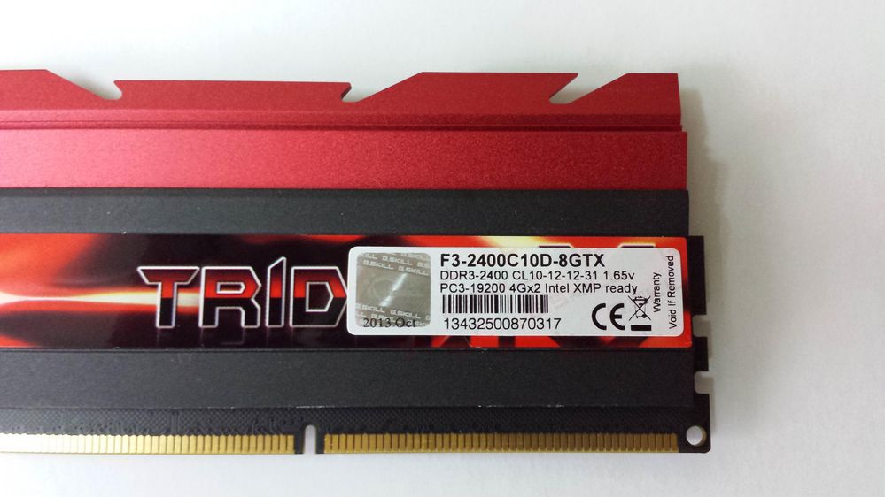

Step 4. In order to configure your RAM properly, you need to input the the frequency the RAM was tested to run at, the correct primary timings and the voltage it needs to run properly. You can find the timings and voltage for your specific kit on the sticker that all manufacturers put on their sticks. Here you can see an example of the timings on our G.Skill TridentX 2400MHz stick.
[/HR]
28836
Here’s a quick crash course on memory timings. The primary timings consist of 4 numbers in this order: CL (CAS Latency), tRCD (RAS to CAS Delay), tRP (RAS Precharge) and tRAS (Active to Precharge Delay).
Now, let’s deduce the timings for our specific kit of TridentX RAM.
CL – 10, tRCD – 12, tRP – 12, tRAS – 31

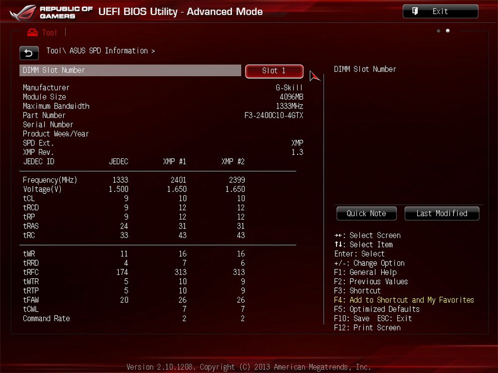

But what if you've already finished your build and you don't want to pop off the case cover to look at the sticker? No problem. First you need to situate yourself in the Boot tab then press the right arrow to reveal the Tools tab. Now, choose the Asus SPD Information option.
29158
As you can see, all the X.M.P. profiles that are available for your RAM will be listed here. You can see the frequency of each profile, the voltage to run at this frequency and the primary timings that we will be changing further on.
Step 5. What we will do no is type each timing into the corresponding section. Hit ESC when you’re done to return to the Extreme Tweaker section.

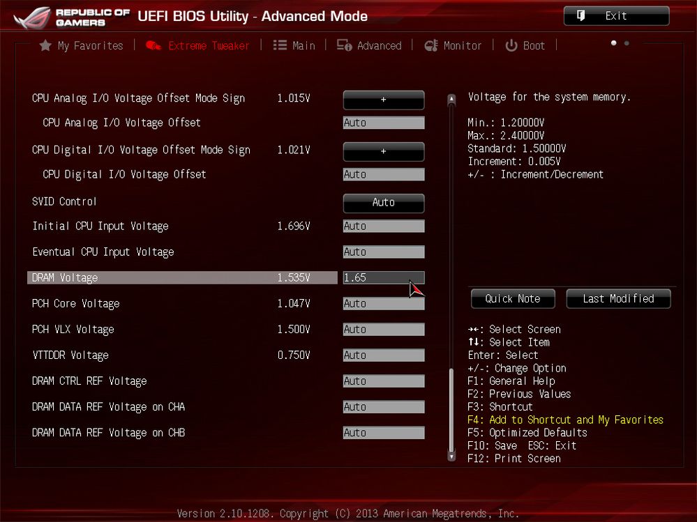

Step 6. Navigate down to the DRAM Voltage option and input the voltage that was on the sticker.
[/HR]
28838
