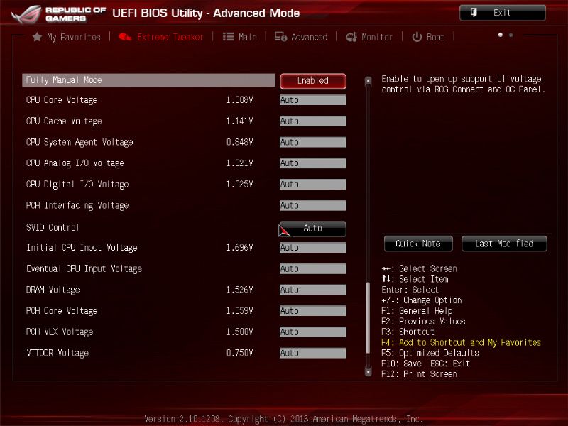

Hi Nate,
Okay, manual mode setting of the memory will get me past the power supply startup without hanging at 15.
I will change the System Agent Voltage from 0.848v to 1.15 maybe higher if I see a problem.
I will attempt to attach screen shot of the BIOS. Both are at Optimized Defaults settings.
33476
Thanks Nate,
Pete
Nate152
Moderator
.848 seems a bit low for the system agent voltage so yeah try it at 1.15 first and see if you have any luck in xmp mode.

Nate,
Thats what I thought too. But then I was looking through the "UEFI Guide for Overclocking", it has a screen shot that shows 0.816v when in Auto. It also mentioned that 1.15 - 1.30 is more than enough for maximizing DRAM clocks. System Agent Voltage is also call VCCSA I found out.

No problem pete, The system agent voltage (vccsa) is for the IMC on your cpu, I'm pretty sure you give this a bump this will fix you up. And yes please do tell if this sorted your problem.

I added .302v to System Agent, 0.848v to 1.15v. The OS doesn't freeze or give BSOD's during logins now, so far that is. Thanks Nate!
