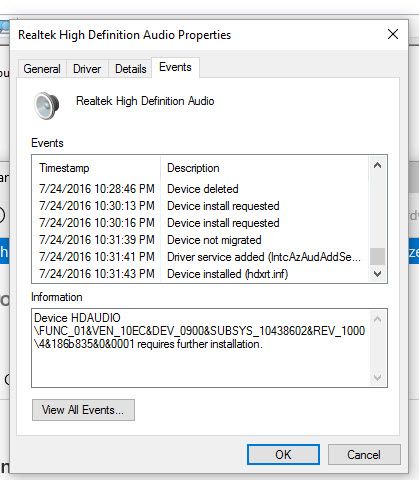

I did notice one interesting thing. In Device Manager, the date and version of the driver was 6/17/2014 and 6.0.1.7272. Which is puzzling since Win10 says that is the latest. If I go to the ASUS Reltek area and download the driver that says it is 7/8/15 and 6.0.1.7525 and install it, the Device Manager still says 6/17/2014 and 6.0.1.7272. This is crazy. Did it not change? Then I tried to uninstall the driver from Device Manager. It displayed the Device Driver info for the Realtek device blank. I then re-booted, went to look what was in device manager, and now it says 7/8/15 and 6.0.1.7525.
Also, in the event window for Device Manager, it shows the following
58398
notice there is a line that says device not migrated. I have not been able to get clear info on this. Somebody says that that is ok as long as there is a line that follows that says device installed. Bad or OK?
