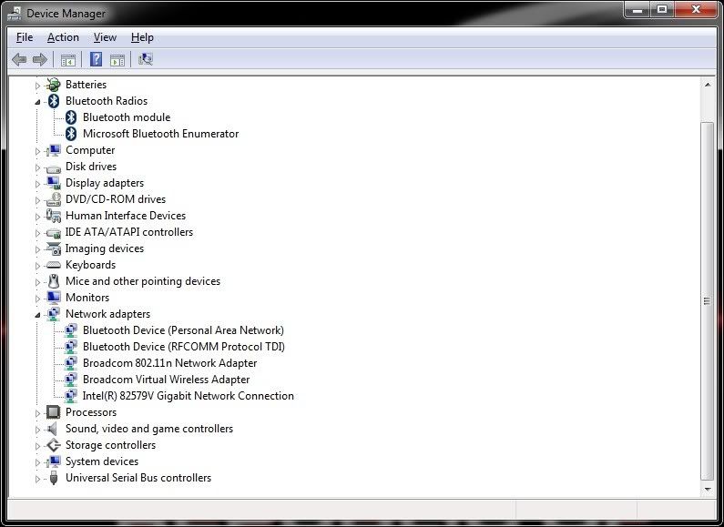

Is anyone else having trouble with the Broadcomm miniPCIe wi-fi/bt adapter? I can't get into a "connected" status (see below). The drivers have all been installed and each adapter shows up fine in Device Manager. Each one has a red X in the lower left corner of the icon and a "not connected" status. I'm not terribly good with networking and I've searched around for an answer but the methods I've tried (like totally removing all Asus network software and & drivers then reinstalling it) haven't worked. Looking at other threads on the ROG boards there are problems with the Broadcom adapter.
Any clues?
Broadcomm 802.11n Network adapter
Broadcomm Virtual Wireless adapter
Bluetooth Device adapter

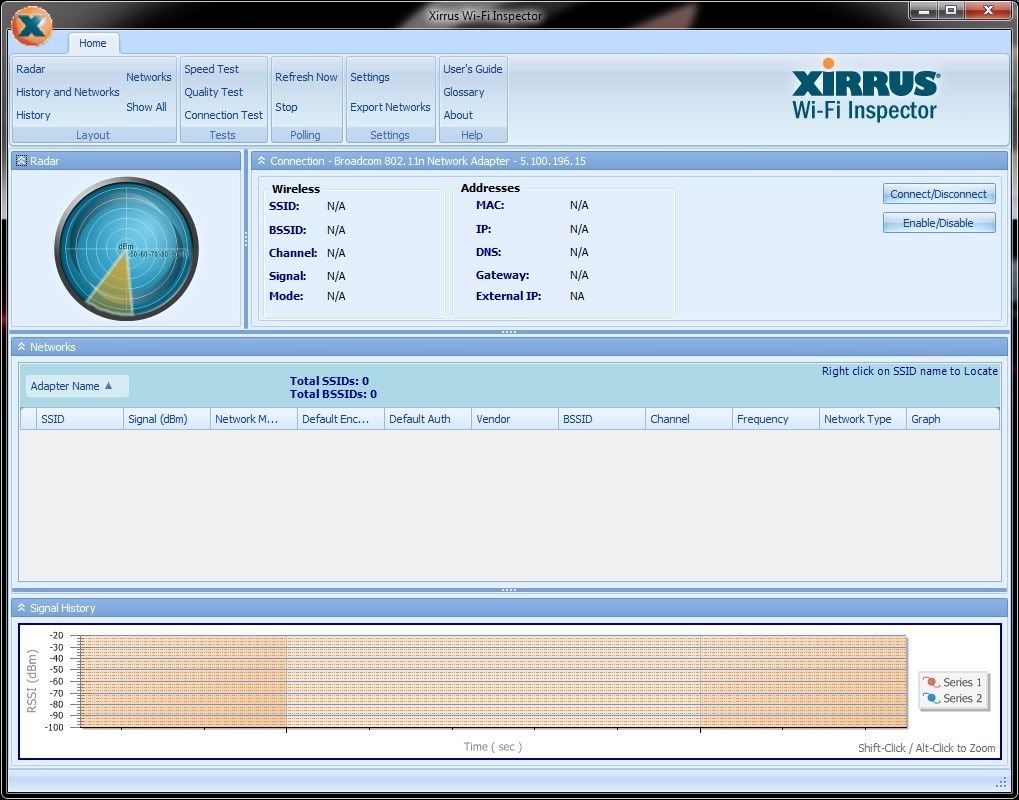

Finally, this is what Wi-Fi Inspector shows.
