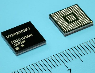

uPD720200 is this little feller:
6153
ur NEC USB 3.0 chip.
i think u got 2 atleast two of them on ur MIVE board ^^

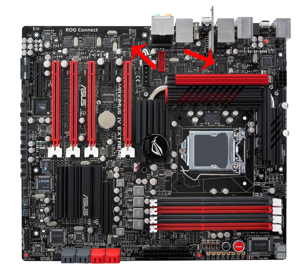

yap u got 2 of them position here:
6154
6153
6154
