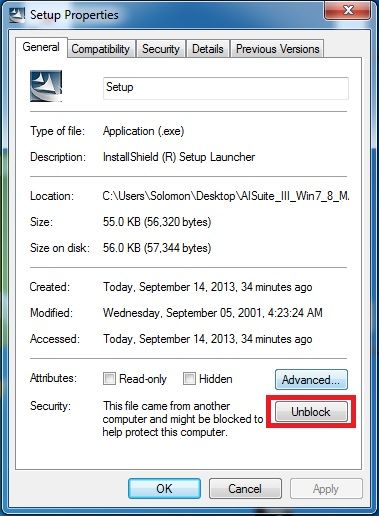

thanks, this was very useful and i had a feeling this was the issue. but for me it didn't stop there. i also had to "unblock" those files and the "asussetup" file in the main directory of the installation folder.
to "unblock" said files, you right click on the file, go to properties and hit the unlock button, (shown in the picture below)

Unblock works if you unblock the .zip before extracting installer, setup ran normally afterwards
