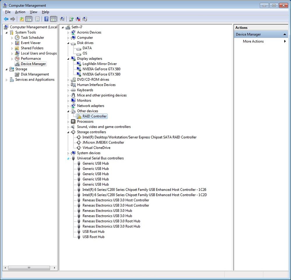

Also can someone point me to the file I need to install to fix this raid controller issue. Drivers for this device are not installed (Code 28). I'm guessing they are the marvell drivers, but the ones I used dont solve the problem 😕

click for larger image
