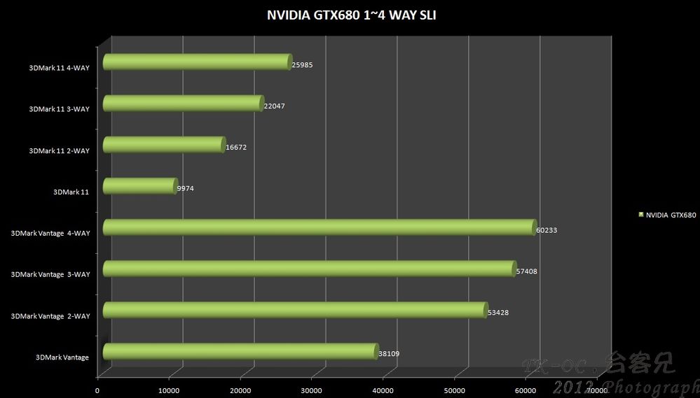

For GTX680 1 ~ 4 way SLI performance competitions are as follows: (Network Information)
19648
Above for your reference
