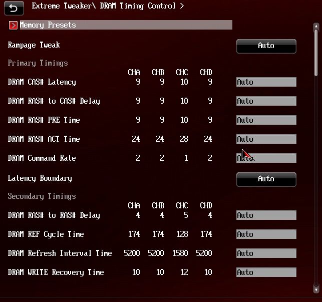

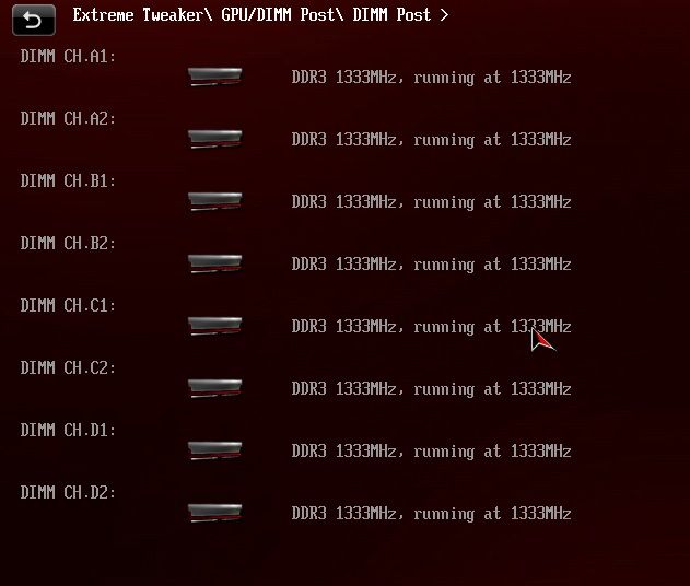

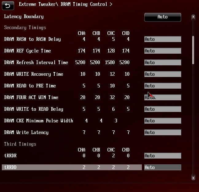

I am having a similar issue. With 2 kits I get the same issue as with one kit though. In my case A, B, D channels work. C does not. With 64MB it says both C slots get Dram error.
I have the same issue using one kit only. With one kit I only have 24gb. I tried both kits by themselves. I swapped the dimms out of the good slots to make sure none of the memory is bad.
Tried running in XMP and stock 1333 optimized defaults. Tried all the custom settings in the Memory sticky guide for RIVE. (manually setting the timings to XMP settings makes the timing numbers much closer than with XMP/Auto)
482554825648257

When you say channel C does not work, is that a hard failure? Unrecognized in Windows? Does the failure stay in channel C when DIMMs are moved or does the error follow some of the DIMMs. BIOS appears to recognize the DIMMS, but as in the OP case, recognition comes from SPD which does not use all the DRAM connections.
In the screen shots, channel C auto timings are greatly different from the other three. That's the sort of difficulty we see with mismatched kits when trying to use XMP or the board's defaults. That would be an example of soft failures - ones that respond to manual timing settings or or using a more compatible kit. Timing differences like this can also come from hard failures screwing up the BIOS attempt to set timings.
